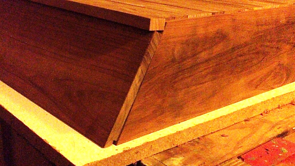

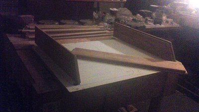

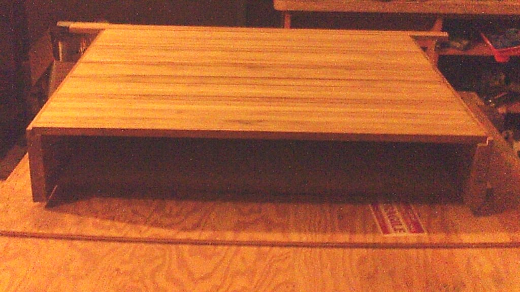

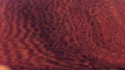

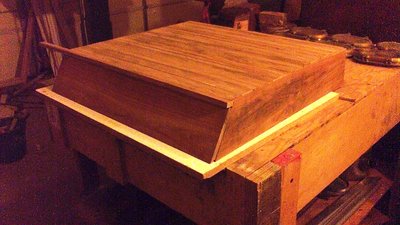

Ok, so here are all the pieces straight off the table saw and router. Still have to trim up the first slat to fit. Also have to add the contour on the front piece, but I've got a template made for the curvature so that shouldn't be a problem. The last photo is a close up of the rosewood that I made into U-channels to cover the aluminum hatch tracks, as well as the mating surfaces on the underside of the hatch. That makes a low friction rosewood on rosewood contact, and provides a really smooth sliding action.
I need a better camera.
