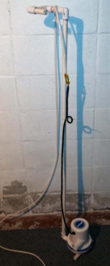

I know I need a washdown arrangement for the deck, primarily for cleaning muddy anchor rode and chain on (manual) retrieval. I am aware of the many washdown kits available with pressure-regulated diaphragm pumps providing garden hose like performance (adjustable, hi pressure but relatively low water volume).
Separately, I have already fashioned an emergency-portable 2000 GPH (centrifugal) bilge pump (and plug) set on the end of a 6-foot PVC pole intended for dipping the pump into a flooded cabin or over the side hooked onto a stanchion base. With its large 1-1/2" unrestricted (no nozzle) output hose and hi capacity, it'll deliver a whole lot of water but at only modest pressure, not a jet-stream.
The core question is how "valuable" is the higher pressure delivered by a purpose-built washdown pump & hose nozzle for various deck-usage scenarios? I'm not sure I see the need to shoot water 30 feet as provided in washdown designs. The popularity of diaphragm washdown designs probably speaks to their superiority in this application, but I thought I'd pose the question since the bilge-pump design probably delivers 6 or 8 times the volume of water; and that'll flush a whole lot of muck even at lower pressure.
If the emergency bilge-pump unit I've already built will suffice, I'll save some time, effort and (my favorite) money.
Thanks... Hank

I'll post a pic on the bilge pump rig when I'm done later today... I need to finish it off with an inline switch and secure the leads.

I'm trying to picture your bilge-pump-wash-down set-up and how many hands it requires. I bought a used Jabsco pump last year but haven't installed it. I use a bucket and brush, but always seem challenged to keep the slime from sneaking down the scuppers. I'm hoping a broad fine high-pressure spray will help herd the scum over the sides. I like the prospect of having a hand free to grasp a brush or a hand-hold.

I started with a 1" PVC Tee piece and glued 3" extensions to the two opposing legs (the stub of one shows under the pump in the photo). The third leg of the Tee also got a stub glued to clear the pump for the elbow to vertical. To the three stub extensions I bolted the 2000 GPH pump's detachable baseplate (The plate had 3 pre-drilled holes in equalteral spacing for perfect alignment).
Then I glued 1" elbows and straight runs to create the dipper as shown; with the crook-loop at the top for hanging onto a stanchion base with the pump over the side. Power comes from butt-connected #12 AWG with an accessory plug end that'll reach one of the boat's 4 accesory receptacles from anywhere in the boat. The hose will be hardware-store 1.5" ID sump pump hose or similar.
Because this is just a centrifugal pump that must run continuously, I'll have no hose nozzle. If it is plugged-in, it'll be running (an inline switch is possible if one wants on-off convenience nearer the rig after its plugged in). The whole thing, with a $30 gently-used large capacity pump from eBay, was maybe $45.
I should add I considered plumbing the pump into the lower-end of the PVC dipper itself (capping one stub and plumbing into the other) which would have allowed the hose to take-off from the upper end. But with this 2000 GPH pump's 1.5" outlet I would have needed 1.5" PVC which was too bulky. The primary purpose of this rig is as a portable emergency hi-capacity pump. If it also serves as a washdown rig, so much the better. (A smaller capacity pump with 3/4" outlet plumbed into 3/4" ID PVC would be cheap and work nicely, and still might move enough water for low-pressure washdown purposes.)
