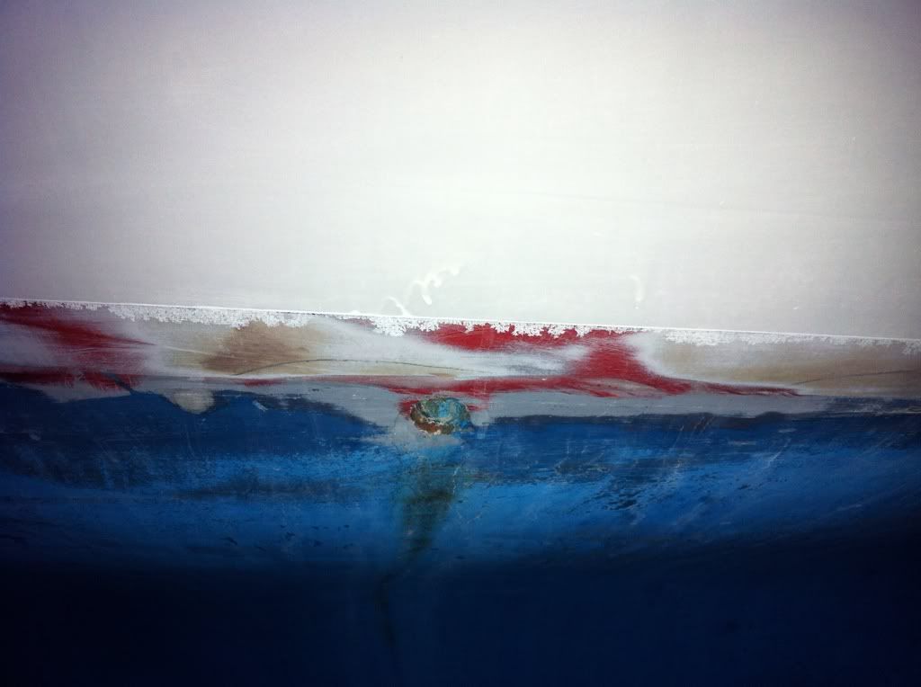

Forward drains:

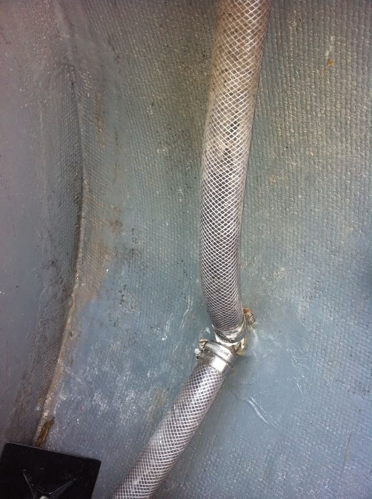

Starboard drain tube:
Port drain tubes:

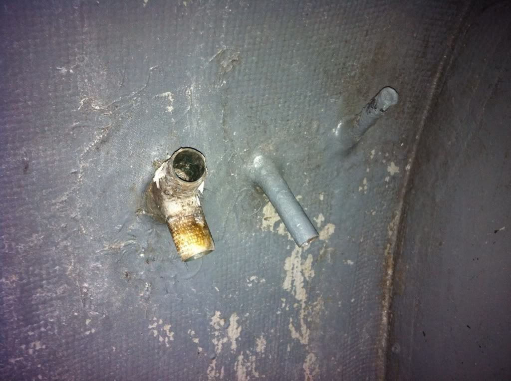

As you can see, also on the port side are two additional glassed-in tubes, previously for raw water and sink drain. The PO filled them in with thickened epoxy.

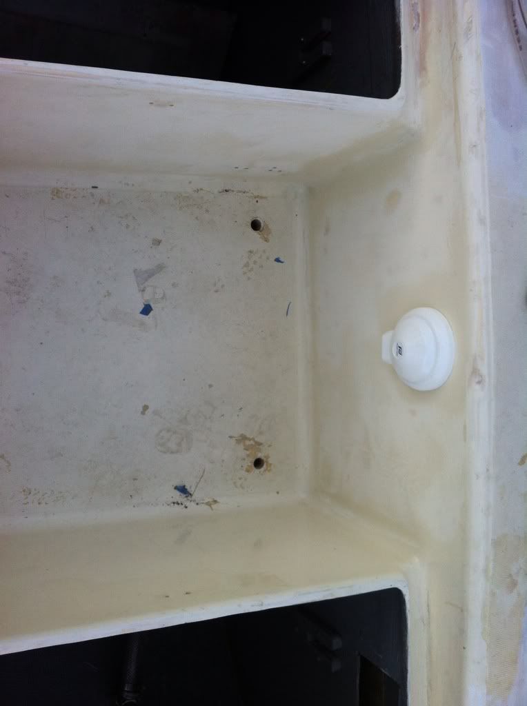

The aft port drains go through the bulkhead and drain into the lazarette (and thence through a one inch hole forward of the outboard well).
Water comes through them in following seas.

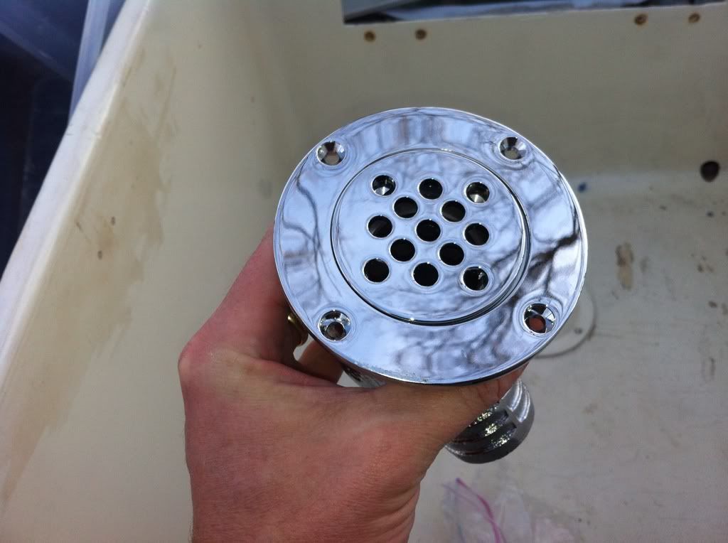

I recently bought four 1.5 inch Perko cockpit drains off Ebay (for the extraordinary price of $20 apiece).
So I'm thinking about for the aft drains, and filling in the existing drain holes and installing one of the new 1.5 inch drains in each corner. Something like this:
