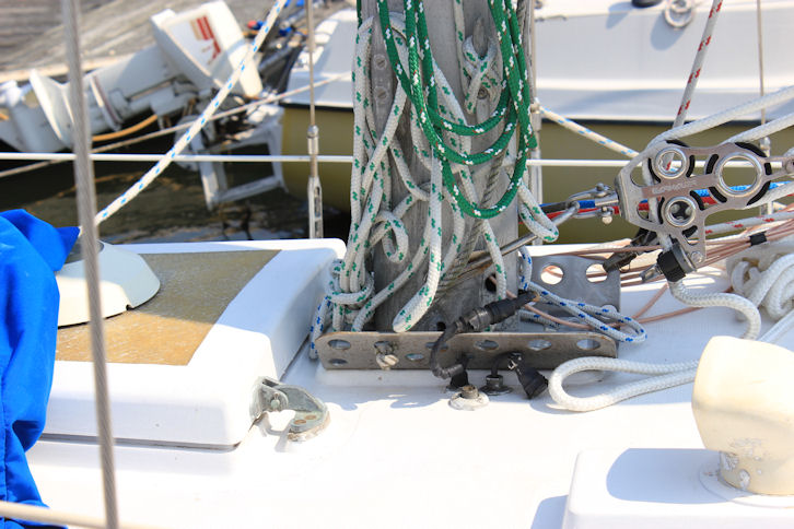

Are your frames anodized? if so no need to polish. If not I suggest you get the cleaned up and then clear powder coated, if you polish them and then subject them to salt water they will corrode, they will get white and ashy. I had some of my mast step pieces clear poweder coated after they were soda blasted

Re: Polishing aluminum
Here is a better picture, just had to locate it
