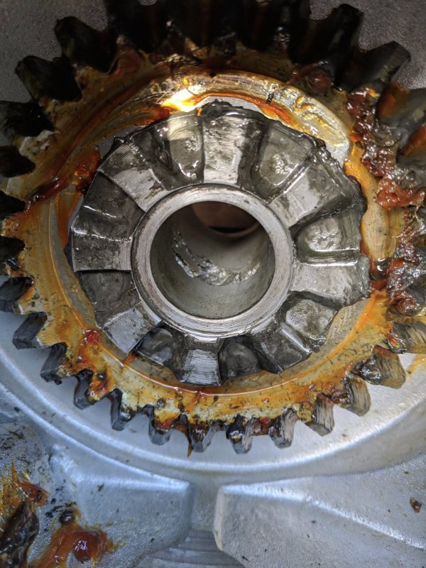

Hi,
The slop seems to be in the plastic bushings and as you suggest, I saw them online at p2marine. The windlass is also stiff on the line side of the winch. Check out the casting flaw in the gear on that side. They want $84 for a new gear. Think I'll get one of those too. Is this gear just pressed into the ring that holds the break handle? .

Re: Lofrans horizontal gear play
I didn't fully disassemble the drum side since I had no problem there so not sure about the assembly of that. Keep in mind that even when new there is a surprising amount of friction or resistance when you crank the handle even with no load on it. I guess it's just the spring loaded gears. There should be very little friction on the bushings though so make sure you have good clearance and grease them up for waterproofing. A canvas cover when on passage would probably help too.
