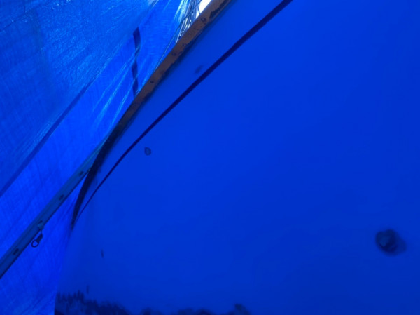

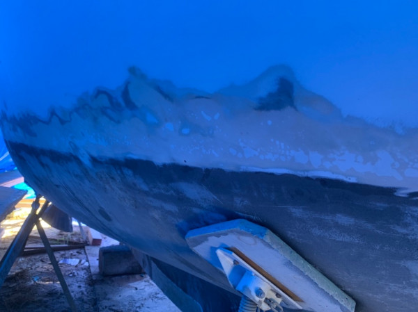

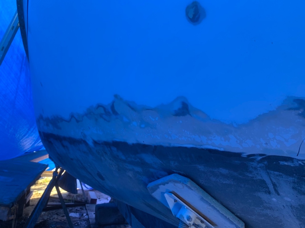

Here are some pictures of the hull
Re: Fairing the hull for topside paint
People tend to recommend what they're familiar with, myself included, so there's that bias to consider. The next thing is, for various reasons, don't expect a consensus of opinion on anything. Having said that, it looks like you can fill low spots deeper than 1/8" or so and any cracks that you V'd out with a dremel with a colloidal silica thickened epoxy like West System with 406 additive. That's tough to sand so don't use it for final fairing. After feathering the surface and sanding any 406, apply 407 fairing compound or equivalent (all the popular ones will work) to any remaining low spots or roughness remaining in the surface and sand it fair with the 5" random orbital sander. If you're not skilled with the orbital then you can experiment using a long board but it's slow and laborious and shouldn't be required in this case. Larger areas of low spots do need a long board in order to span the low spot and not undercut it causing waves and ripples in the finish. Also, get the area smooth to eye and hand before priming and don't expect the primer to hide any roughness.
