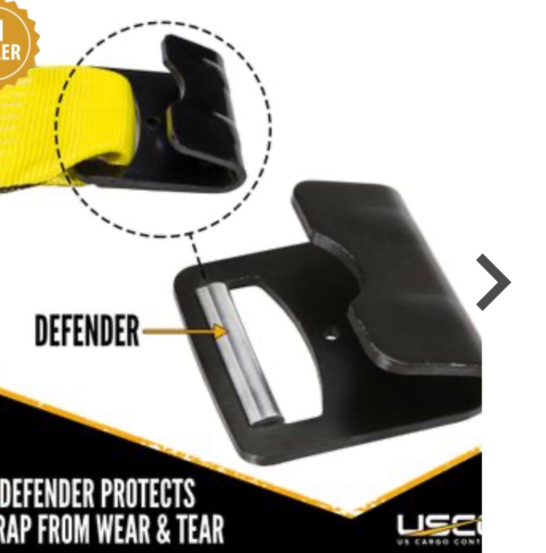

These are 4 inch ratchet straps with the powder coated flat metal type hooks and the round metal protector on the hook to protect the strap where it takes a turn on the hook, before being stitched down.
