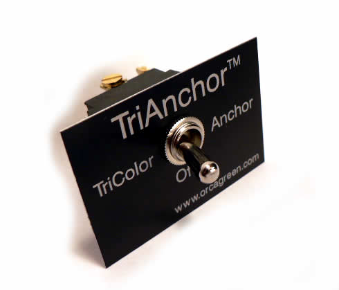

Why not run the wire for the tri-color from that switch to a follow-on SPDT switch with one position being the tri-color and the other being the deck mounted running lights? That way you are assured that only one or the other will be illuminated, not both.I have a tricolor and deckmounted navlights. It would make sense for me to wire in tricolor for sailing only but I use either the tri color or the deck-navs when I'm sailing. Wiring it the way they recommend would preclude me from turning on the deck-navs without the steaming light.
Reason enough as I see it not to use that switch, as clever as it may seem. Tricolor is really for off-shore. The Coast Guard still hasn't recognized mast top running lights. Not being able to use deck running lights alone, like you have expressed concern about, would be irresponsible if you ask me. The mini panel thing Tim shows allows any combination. It does however leave the responsibility of using only proper combinations up to the operator.Ceasar Choppy wrote:
