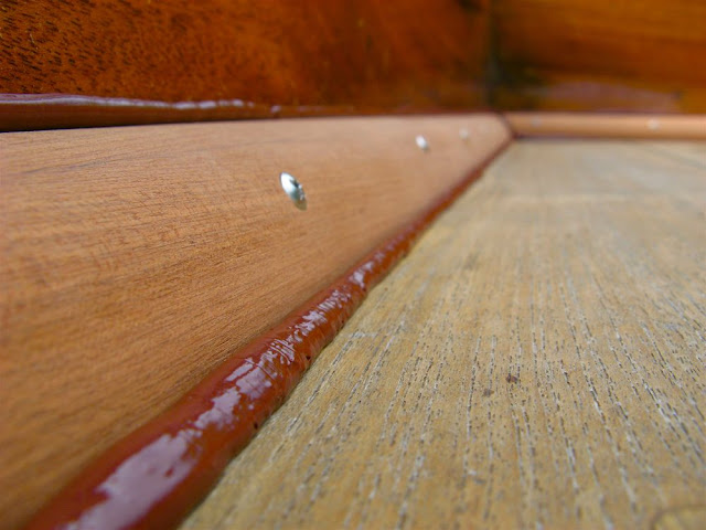

The covering board on the joint between cabin and deck was also bedded in Lifecaulk. That failed sooner. It appears water wicked up from the deck joint and then behind the trim working under varnish, into screw holes. The surfaces behind the covering board were wet when I easily removed the piece, little adhesion left in the life caulk.
I think I was too light on the amount though back 10 years ago and now know, you need enough compound to squeeze out fully at cabin and deck. I had many voids at the base to allow water to work into the joint.

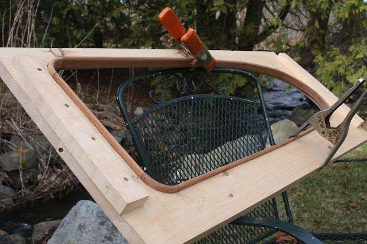

So I need to cut new trim pieces around the windows (I reused them last time but it's time to cut new ones) and will rebed the glass, trim, covering board, for a good 10 more years.
