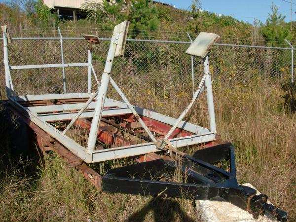

New to this board but been lurking and gleaning info for some time. I finally secured my plastic classic, but need to get it out of the water pretty soon. I need some advice on building a steel cradle for this boat, a 32' Columbia Sabre, approx 5000lbs (less I hope).
My question is about steel sizing. Is 4" c-channel heavy enough for the base, and 2" angle for the pad braces? I know bigger is better, but weight and cost, mostly cost, are driving factors. I've tried to attach a picture of something similar.
Thanks for any advice.

My steel cradle is built of 4" X 2", 5/16ths wall thickness. It is definitely overstrength and 1/4" would be ok.Abier wrote:My question is about steel sizing. Is 4" c-channel heavy enough for the base, and 2" angle for the pad braces? I know bigger is better, but weight and cost, mostly cost, are driving factors. I've tried to attach a picture of something similar.
Andy
A nice touch is to cap the ends, which is rarely done, but makes a lot of sense. It's more work, but it keeps the water from getting in and rotting the channels from the inside out.
This seems to be a question of local preferences. I've seen stands all over New England, and hardly any cradles. Up here in Canada, it's the opposite, almost always cradles, and very few stands (except for powerboats).Capn_Tom wrote:Is there a reason you have chosen to build a cradle rather than using boat stands?
Cradles take up less space to the sides when the boat is on them, which is a factor in yards where space is tight. I think that they are more stable, since there is more surface area in contact with the ground, and since they are all one piece? Cradles are also less prone to setup errors by crew, and they can be used for transportation on a flatbed trailer.
On the other hand, stands are cheaper, easier to store and are more adaptable.

Yes, 4" X 2", 5/16ths rectangular tubing. This is overkill for my 7500 lb boat, so I am sure you could use something lighter for the 5,000 lb. Sabre. The standard around here seems to be 1/4" tubing, and this is used even for much heavier boats.Abier wrote:Yes, I want to build the cradle for transport on a flatbed that I have. Also, when I have it home, being on a cradle will make it more portable if I need to move it.
Duncan - Do you mean that your cradle is made of 4 x 2 square tubing?
Like with stands, almost all the weight of the boat is carried on the keel, so the uprights don't need to be nearly as strong as the base. They usually are, though, since I guess people just use the same tubing size for the whole cradle. Extra wall thickness is good insurance against rust, I guess, but you pay the price in weight - the crane guy said that my cradle weighs about 800 lbs.
Here's a (not-so-great) photo, which shows it sitting on a utility trailer:
