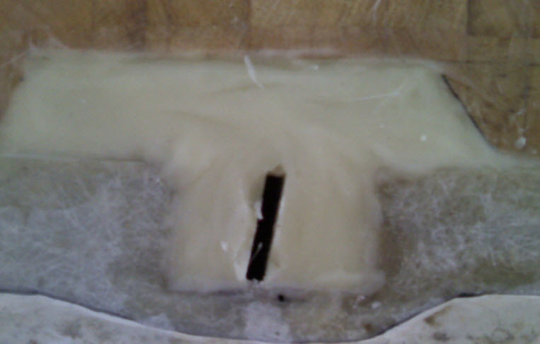

Ok, so I think I might have messed up a bit. I tackled the chainplate areas on the starboard side last night. First I wrapped each of the 3 chainplates in packing tape (clear stuff). Then I installed them and held them in place with a single bolt. Next I laid in 4 layers of biax with unthickened epoxy. Had dinner and waited for the epoxy to kick and then filled flush with thickened epoxy. All good....
Well, this morning I went back out and found that everything was still a bit green but certainly not sticky so I decided to pull the chainplates.
I think this is where I went wrong. I think I should have waited until it fully cured before trying to take them out because the chainplates took some big chunks of epoxy off and generally left a really messy slot. The picture isn't very good, but I think you'll get the idea.
So I guess the question is: How much should I grind out before I can repeat the process (and leave the chainplates in until epoxy cures)?
Re: 2 recore questions
Hard to tell from the photos, but are the missing chunks greater than 3/16" in any direction?
If not, then do nothing. You'll want to chamfer out about that much as a sealant bed anyway.
If so, then still don't do much. Clean up the chunked-out area with a chisel or something, reinsert the chainplate, and patch in a little bit of goo. no biggie.
