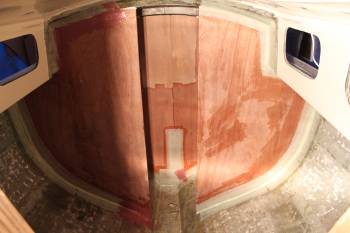

In other news, I've finished putting in all my structural bulkheads as well as completed my hull-to-deck joint and I'm finishing up the exterior glasswork before I prime in a month or so. Things are moving along! Here's a photo of the bulkheads (and as usual, check the blog for updates to the project):
- Bulkheads are in, I will cut the door to the v-berth in place once I've decided on the height I want the v-berth.
