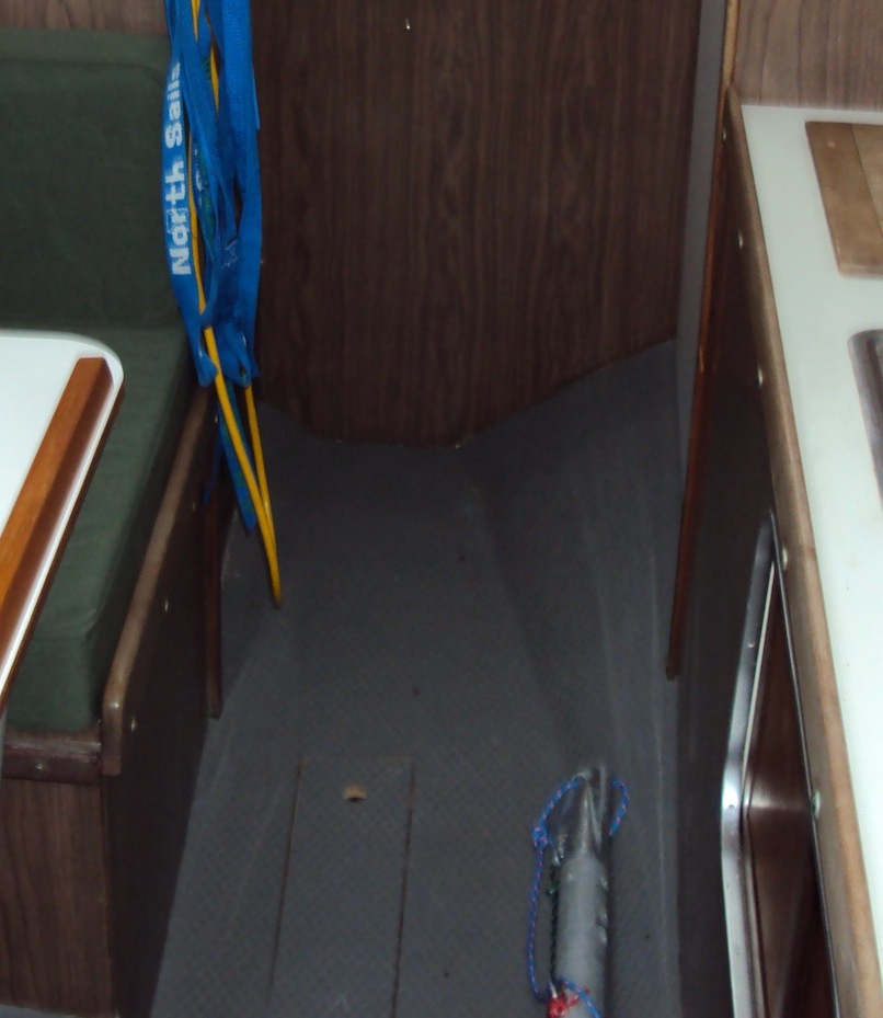

Re: Cabin Sole
I bought some teak and holly veneered plywood for this project, but have been "waiting and thinking it over" for a while (the existing cabin sole is just the fiberglass liner, but later production versions of my boat had a finished teak and holly sole).Hirilondë wrote:...This whole process is extremely tedious and requires exact fitting. It is only for those with considerable patience and the ability for exact fit. I will not suggest that you can or can not do this...
So far, because of the "patience and ability" issues you mention, I decided not try to cover the complex sloping sides of the sole, but just to do the flat bottom.
Even this may be a bit challenging to me, because of trying to cut the sides of the plywood to fit the angled rise at the sides of the cabin sole. Now I'm wondering about cutting the plywood straight, or at a steep angle, and filling in the gap (perhaps caulking with a thin "finishing" batten on top?).
Do you have any advice to offer on this approach?
