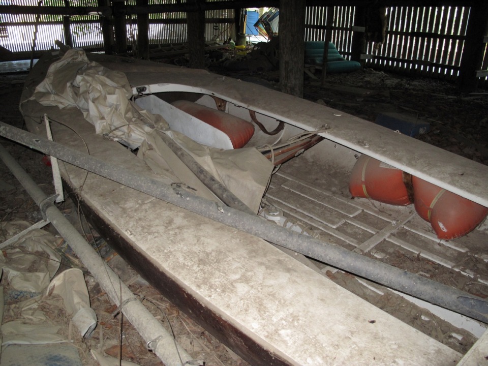

Here's a pic of an FD, as found and recently bought to be restored, with inflated airbags still in place. Clearly, airbags intended to float a keelboat would have to be more robust (and more pressurized) in order to stay inflated at deeper depths.

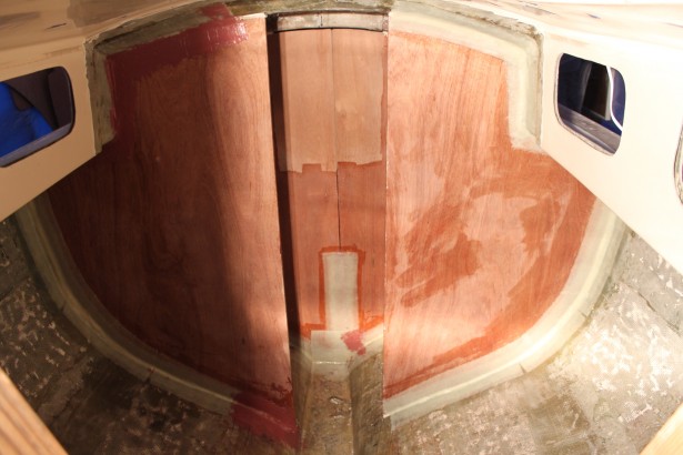

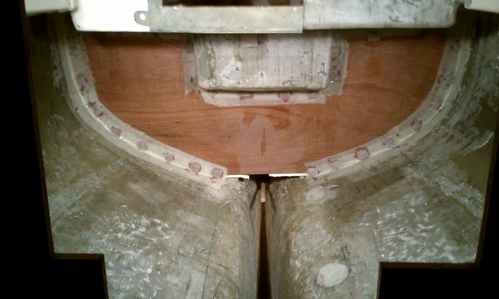

For the moment, I'm attaching photos that aren't incredibly illustrative, but I'll get some better images tonight. For now, I'll explain (in text) what my plan for making my Bristol 27 as safe as possible. Regarding flotation, I have separated my Bristol 27 into 3 logical "sections": stern to cockpit bulkhead, main cabin area, and forward area.
Stern to Cockpit Bulkhead (3 Watertight Areas) - This area is made up of the lazarette, 2 sea lockers and the area below the cockpit. The lazarette will be fully water-tight, as well as the two sea lockers on either side. They will each have drains built into their lowest points which will have a valve on them that I can use to drain the water tight areas when needed (the drain will run to a dedicated gray water or bilge pump, I haven't decided that quite yet, but soon). The area under the cockpit will be accessed with a hatch cut out of the cockpit sole and will not be watertight due to engine stuff (air vents, exhaust, etc. etc.).
The two sea lockers in this area are very deep. If I filled their lowest point with flotation foam (up to about level with the cockpit sole) which would give me (very roughly) 1.5 - 2 cu.ft. of foam in each locker.
Images: (Not at this time, soon though.)
Main Cabin Area (2 Permanent Watertight Areas, 1 Flexible Area) - This area is from the cockpit bulkhead forward to the first mast-step bulkheads. The head and hanging lockers areas will have a bulkhead that runs from the main salon bulkhead, to the mast-step bulkhead. For ease of use, let's call this coin this the "splitter" bulkhead. The two "splitter" bulkhead will be as high as possible, but most likely will end up being around 8 inches above the original waterline of the boat. I also plan to add a "flexible" way to split the area between the salon bulkheads using a slide-in board, creating an additional watertight area in the salon.
I will also be adding flotation foam below the head platform and obviously all around the icebox.
As for the main salon, due to storage and ventilation concerns, as well as the height of the settee sides in relation to the waterline, I won't be able to create many water tight areas in the main salon area where the settees, galley and nav-station will be, so there isn't much flotation here to speak of.
Images: Forward Area (3 Watertight Areas) - This area is from the mast step bulkheads forward to the bow. It contains 2 watertight compartments below the v-berth platform and the chain locker. The tops of the two below-v-berth lockers should be around 8 inches above the waterline. The volume of these two lockers also decreases as the bottom of the boat rises to form the bow of the boat.
I have calculated the largest of the two below v-berth lockers will hold at least 120 gallons of water before the water would spill over the top into other areas of the boat. This "large" locker will be further subdivided in half, that will serve to build out two sections, each of which will contain a water tank of a yet unknown volume (somewhere around 40 gallons each by my current calculations). I consider these tanks to be permanent flotation volumes since they are completely sealed and can be drained and used for flotation in a pinch.
The chain locker will be sealed from the rest of the boat and an opening to access the chain inside will be well above the waterline.
Also note, these lockers will also be drained by a valve-controlled PVC pipe that runs all the way to the bilge (Just like the Stern to Cockpit Bulkhead area, I need to decide whether to use a gray water tank or a dedicated bilge pump.).
Hopefully that all makes sense. The main goal is to make this boat as safe as possible and to avoid allowing the entire boat to get swamped unless it was really, really bad conditions. The flotation foam is just trying to offset any weight that I can. I had considered air bags, but the problem is you need a way to quickly inflate them, which, as I understand it, requires some sort of air system to really be used in an emergency.
