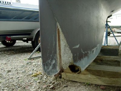

One of the Lecomte Northeast 38's, Agave, was blown over a coral reef in the Bahamas a few years back, and had the hollow part of her keel dragged violently over the coral and badly scored. As the boats were laid up in two halves and tabbed together, the amount of glass along the centre joint is prolific, and the boat was towed off and sailed back to Florida without mishap (there was a small leak that the bilge pump took care of).
http://www.lecomteowners.com/index.php? ... &Itemid=41
http://www.lecomteowners.com/%20index.p ... view&id=69
Hal Roth's Spencer 35, Whisper, was blown ashore in deep southern latitudes prior to their rounding the horn - it had a huge gash torn out of the side of the hull - but all the damage was done to the hull, the keel (with a large hollow) survived relatively unscathed.
I guess my point is that there are lots of parts of our boats that would be negatively impacted by running into something solid, and trying to strengthen each of them in turn will result in a rather heavy boat that you probably won't enjoy!

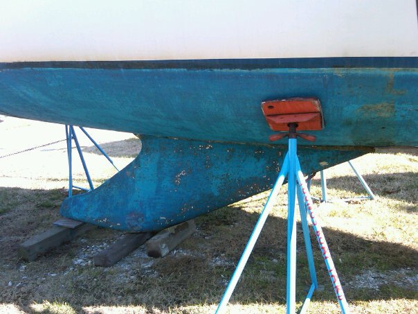

One other thing to be aware of is how your boat is blocked on the hard. Yards will sometimes block the keel fore and aft -- primarily to take the ballast (and hull) weight and stabilize against toppling with hull poppets. Advise your yard not to block under your sump, and only under the ballast. Else over time, at least on my boat, the plastic sump will deform a bit.
