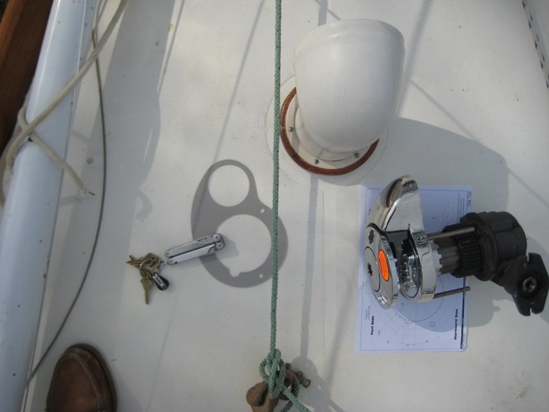

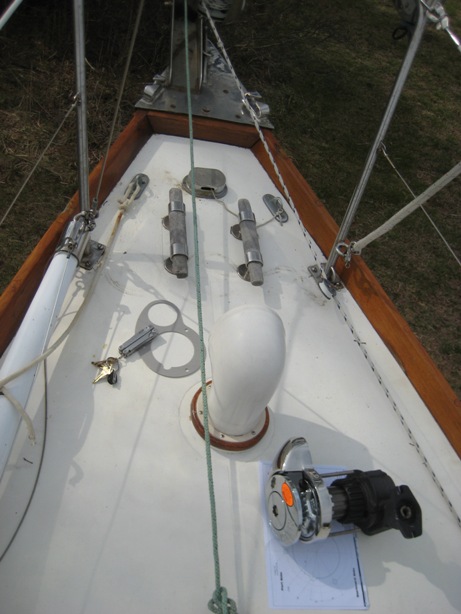

Below are pictures of Quetzal's chain locker and foredeck. We have purchased a Maxwell RC8 winch which mounts through the deck; motor and transmission are below deck. The instructions are picky about fairlead and orientation of the winch with respect to the rode. +/- 5 deg horizontally and zip vertically. Means that I'll have to build a tapered mounting block to tip the winch up to line with the rode. They're also picky about the anchor roller; they say that the anchor has to self-launch rather than sit serenely in the roller as mine does. The area of the foredeck forward of the forepeak bulkhead is cored with Airex foam, probably an inch thick (but I'll be finding out).
There are two possibilities, shown in the pictures, for locating the winch: one forward of the vent and one aft. Forward seems like lots of stuff in one place. Aft would dump the rode just inside the bulkhead door. Additionally, I have one foot switch and a flush hose connection to find room for. I don't see any need to change the amply-sized LeComte cleats; Maxwell says you must cleat the rode to take the load off the winch. If I ever go to all-chain rode, I'll have to find room for a chain stopper.
The amount of tip that I'll have to build into mounting block is about a 1/2" in the length of the winch. I think that I'll make it in a piece of McMaster-Carr fiberglass and paint it white. An alternative would be to make it in Teak, like the trim ring on the vent, but I think I'd make new trim rings in fiberglass before I re-restore those Teak trims! I don't think I need to make a tapered back-up block for under the deck; surely a flat aluminum back-up plate and tapered washers would be fine.
I bought only one foot switch; I presume I'd use in for 'up'. The winch comes with a bulkhead mounted switch for near the steering position and a pocket wireless switch. It also came with its own breaker and a massive relay box to be mounted 'near the winch but not in the chain locker'.
Comments are welcome! My questions include: is the path of the rode, represented by the green line, clear enough of the cleat and vent? Have I left enough clearance around the winch and cleat? Which position is 'more better'?

Re: Locating Anchor Winch
The vent is where the windlass wants to be.
Move the vent.
Move the vent.

Figue, why say you 'Move the vent?' The winch has to go somewhere along the string as it projects straight aft from the roller. I will admit that I knock the plastic hat off nearly every time I anchor; nothing holds it on but a little friction and I'm remarkably clumsy. If I'd had a say in it, the anchor roller would be to starboard to suit the asymmetry of the winch, but I didn't and I'm neither adding one nor moving the one I've got.

Maybe its just me but most sailboats I see with dorade vents up near the bow... tend to have it offset. Not on center. You could move the dorade vent to starboard and more aft. Then put the winch right where the dorade vent used to be.
I'm not overly keen on chains dragging over a long distance from the anchor roller. Some do this but add a stainless steel plate on the deck to protect it from the chains. I think overall, it may be just easier to move the dorade vent elsewhere and put the winch right there where the dorade vent used to be. You could even do without the dorade vent, too. If the boat gets too musty then you'll just reinstall it.

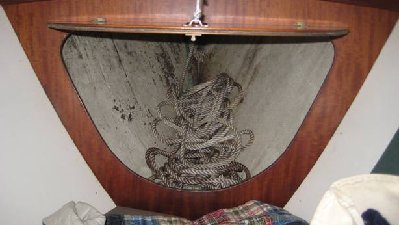

I assume you are using some chain? 25 ft.?
When hoisting the anchor with chain, even if just the last 25 feet or so the chain bounces up and down as links cross over the roller and/or around the gypsy. All of the systems I have installed have chafe guards on the deck to keep from wearing out a channel in the deck from this action. None of them have cleats, vents or anything else withing 6 or more inches either side of the path of the rode to assure there is no fowling. I think your present plan of not moving the cleats and vent is looking for trouble.
BTW, of all the electric windlasses I have installed, Maxwell has proven the most reliable and functional of all.

Case, thank you for the comments. Sadly, the winch cannot go on center as my eye would suggest is appropriate, because the existing roller is to port and the majority of the winch is to port of the pull.
Jack, your and Case's comments re damage by bouncing chain suggests that the forward position is better, since less chain is free to be flung around. I may indeed need to move the cleats outboard.
The vent stands in a non-skid free area of deck but I will most likely have to remove all the nonskid as I repair cracking (the usual ones at the forward corners of the house and the corners of the cockpit) in the deck prior to repainting. Perhaps the vent can go where the current (what's it called, hawse pipe?) covered hole for the rode is. I was sorta' thinking I'd keep the ability of having two anchors and two rodes in the chain locker (adding the separator, of course).

I say move the vent because it's an unneccesary constraint on this installation. If the vent weren't there, you wouldn't be considering locating the windlass so close to that port cleat, would you?
To my eye, the windlass wants to be located almost exactly within the footprint of that vent. The vent also happens to be located pretty much ideally in terms of the fall of the rode in the locker below. My read on those installation constraints is that the rode must enter the windlass within that 5degree window. That dictates orientation of the windlass, but is not a 5degree constraint on the relationship between the rode and the roller. Will a bit of misalignment between roller and rode create problems? Will the anchor be banging into your furler drum? I dunno but it's worth a look.

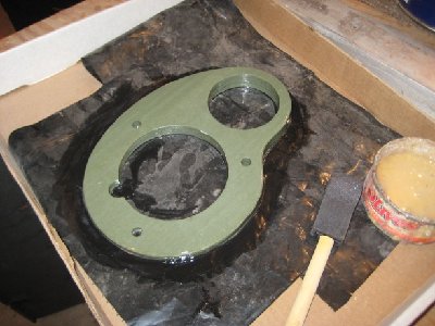

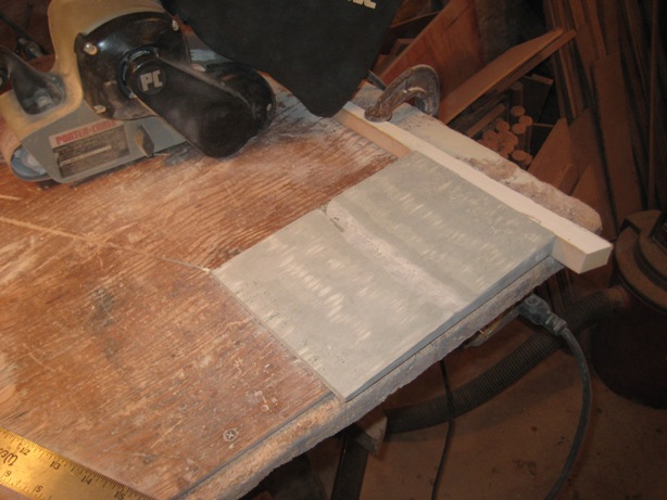

Got my McMaster-Carr slab of fiberglass today and roughed out and epoxied the two thicknesses for the base. I'll mill the taper tomorrow (it's to be raining) and we'll have a look at the thing again on Wednesday.
A concurrent project is freeing up the sliding settee. It had gone from difficult to move in 2004 to all but immovable last week. Turns out that the thing slides in heavy aluminum channels which were fastened to the adjacent bulkheads with 1/2" x #10 bronze flathead screws. A couple of the screws had backed out after only 40 years, and were carving the hidden ends of the settee.

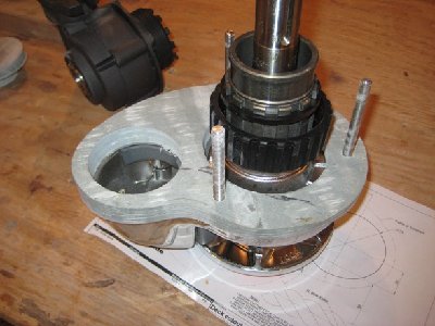

Progress:

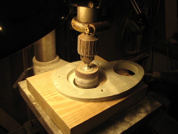

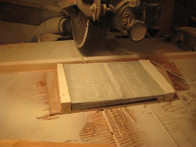

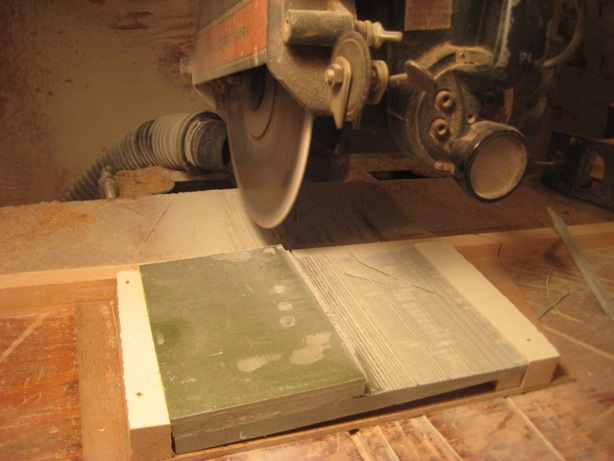

Milling a taper with a simple jig. Shop vac collecting chips and dust. Held the workpiece with a push-stick. Finished milling. Belt sanding both faces. Rough-cut, ground the perimeter. Hole-saw and sand the interior w/ simple jig on the drill press table. Whew! Fit the first time. Coated out in neat epoxy, basically a fill coat for better finishing of the 'glass

Nice photo report! I like the kidney bean shape, and it's interesting to see how you use the drill press and other jigs. That's something I rarely think (or have the experience) to do.
In the shots where you show the (radial arm?) saw and you are milling the taper, how are you actually doing that? Are you just shifting the piece from left to right and then making cut after cut from top to bottom, slowly slicing off more as you go?
Yes, Rachel, multiple cross-cuts is an old trick for doing dadoes or making tenons on the end of something, or half lapping; whatever. It's a bit sloppy, but an effective way to make such a reduction in thickness with a table saw or a radial arm saw. Even a hand-held carpenter's radial saw can do such a dadoe. With wood, one need not remove everything but skip a distance one chooses by one's tolerance for clean-up of the remaining fins of material. You can use a dadoe blade or similar instead of just an ordinary carbide blade as I did for the fiberglass.
I should note, however, that making these pieces of McMaster-Carr's fiberglass has totally dulled this 10" 60-tooth blade and its now relegated to the to-be-sharpened pile. Toward the end, each pass was slower, harder on the motor and you could see sparks as the blade advanced through the 'glass.

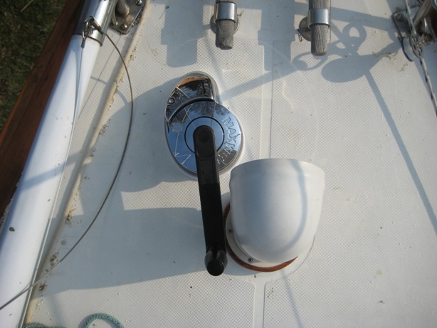

Below are pictures of the finished assembly of the top end. Figment was indeed right: I shall wish to move the vent. On the other hand, I can live with it. One only uses the crank on center to adjust the clutch for free-fall or for under dead-load release (for when the anchor has been pulled into the roller). The off-center hole is for cranking the rode up after the winch is disconnected by means of releasing the clutch. Sounds perfectly dreadful! I'm going to miss the pull-it-up-by-hand convenience!

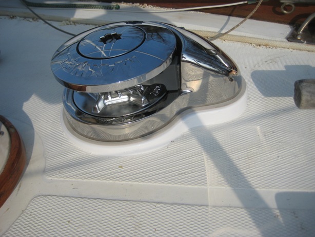

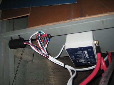

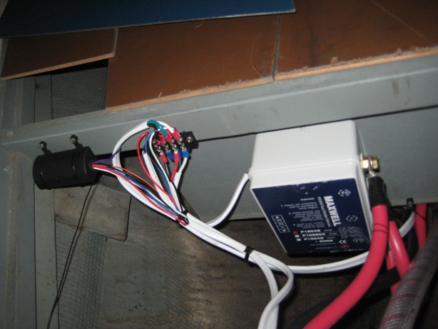

Here's the finished install below:

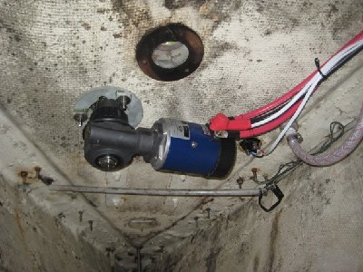

And the controller and wireless radio is mounted under the Vee berth:
