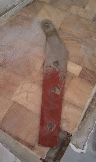

Who would I go about seeing regarding testing the strength of chainplates? I think there is a dye test of some sort but I need to do some research on cost/reliability etc...
I was going to replace all the chainplates for the shrouds and backstay, and still intend to for the shrouds, but I can use stainless flatbar which is reasonably cheap. The backstay is a weird shape though, and using flat bar is pretty much out of the question, so the cost will go up considerably.

Just out of curiosity, what is that chainplate made of? It doesn't quite look like stainless or bronze, from what I can see (which, granted, is not that much, because I can't make the photo enlarge).

Good question, I'm not sure... I noticed the same thing. It is clearly a different material than the shroud chainplates. If I were to guess, I would say galvanized steel. If it is galvanized, I know it's not optimal, but I am trying to find places to save money. If I can determine that it is still sound I can live with it for a season. Of all the chainplates on the boat, this was by far the easiest to remove.
