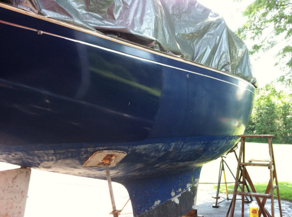

Well, I put PoliGlow on the hull today and am pleased at the very significant aesthetic improvement.
My hull is Navy Blue gelcoat and the application took it from very drab moderate chalk to an attractive gloss / shine. I have used 2-part Interlux polyurethane on another boat and I'd say my 2-pass wash (Krud Kutter then Poli-Prep) plus 6-coats of PoliGlow achieve 70% of the gloss effect of a decent 2-part polyurethane application.
That's 70% of the benefit in 6 hours work in one day versus probably 20+ hours of work over 4 or 5 days to lay down 2 coats of 2-part primer and 2 2-part finish coats. For a boat with low value such as my 1968 Hinterhoeller HR28, I'm pleased.
Of course, the proof will be in the durability of this finish but for a low-value boat, I'm very pleased on Day One.
