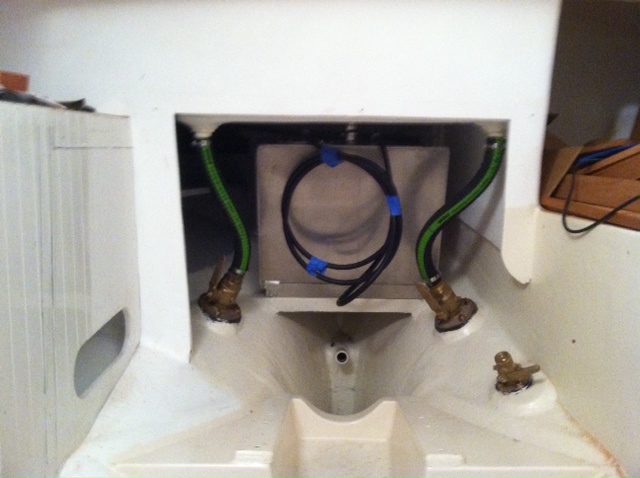

I can't be any help with your question but I can chime in that I am having a similar issue/problem with my new Perko 1.5" Seacocks. I bought Vetus Denouden 1.5" ID water hose for the set up, http://www.fisheriessupply.com/product/ ... ?cid=16052, but the end that fits over the 1.5" barbs on the seacock barely touch. Usually I am having to apply some detergent water to get the hose over the barbs but deffinatly not in the case. The only thing holding them on is the 2 clamps. The upper portion of the connection where it meets the cockpit drains fits much more to my liking.
I would definatly be interested in hearing what others have to say as well. It just scares me to think that if, for some strange reason, both hose clamps broke the hose itself wouldn't be snug on the barbs.
