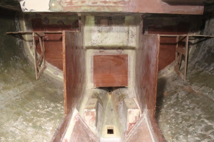

Does anyone know the long term effects of battery acid dripping onto epoxy (which coats fiberglassed plywood & foam)?
I may be using lead-acid batteries which means I must protect the battery compartment from acid spills. The lead-acid in batteries is 35% sulfuric-acid / 65% water (I believe). My research indicates there are certain epoxies that will withstand battery acid...others that will not. I can't seem to find data on West System's resistance to battery acid, however from reading around, it doesn't seem that any epoxy has true long term protection from acid spills.
I've considered are stainless steel battery trays or perhaps buying acid resistant plastic and gluing these together to make a tray (again, the glue needs to be acid resistant). Even with sufficient trays, I could see that some acid could 'jump/squirt' onto the epoxy-fiberglassed plywood side walls, attack this material.
I am also considering switching to AGM to avoid the entire issue (among of other benefits they provide - no need for dedicated ventilation, no off-gassing, smaller size, no distilled water refilling, etc.)
I am planning to install batteries in a sealed (but ventilated) area below my navigation station and engine compartment. Here's an image of the area in question:
Battery compartments templated.  The compartments are the inboard area, to port and starboard.  Shelves will be built low along the hull to hold the batteries.
If you'd like full details on the compartment, I have an write-up on my battery compartments here - http://www.bristol27.com/projects/battery-compartment

CharlieJ wrote:Why not phone the Gougeon's and ask? Their tech support section is always willing to answer questions like this.
You're right, this is likely what I'll do tomorrow. I also wanted to ask here as well, because I appreciate a second pair of eyes on the entire set-up.
bigd14 wrote:Can you just use one of those close fitting plastic boxes that fits in your battery tray?
Yes, I think that's a good option for lead-acid batteries. The 6V Costco batteries I saw measured 32.7cm (12.875") L x 17.145cm (6.75") W x 23.18cm (9.125") H. If I add the battery boxes size to the battery, the length extends beyond the compartment's planned locker face (I already built the side walls for the face; the photo is a little old).
So...silly me, I should have added the battery box size to my wall calculations, but didn't. This is making the smaller AGM's look more and more desirable (despite their cost, more delicate charging cycle, etc.). AGM's wouldn't need battery boxes, because they are enclosed (right?).
