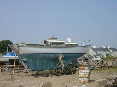

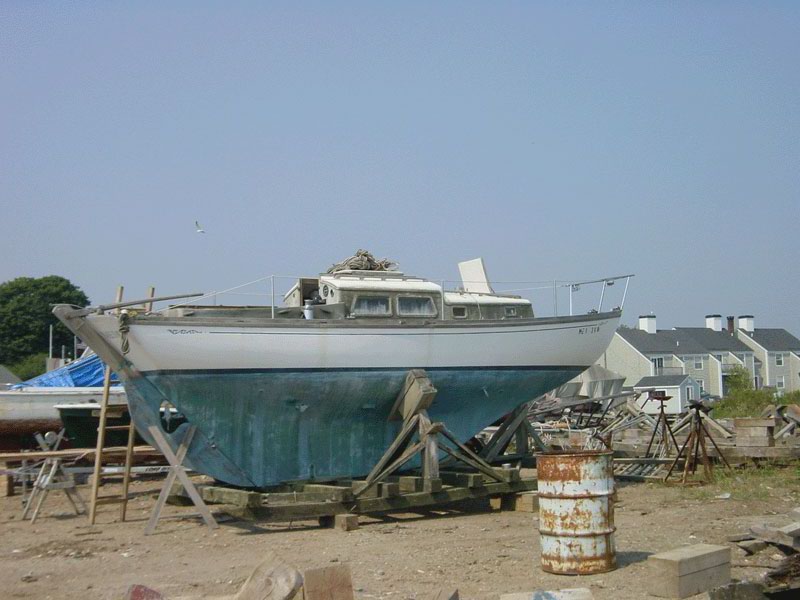

Thanks for the excellent explanation. This is just what I needed. We have a place back in Maine and my wife bought this project boat for my 50th birthday. I am now in Boise, Idaho and trying to decide in which ocean to launch her. Attached is a photo of her back in Maine when we bought her. Thanks again for your advise.
