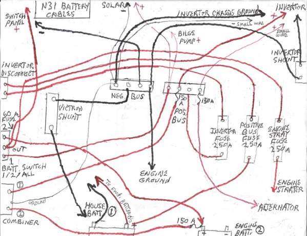

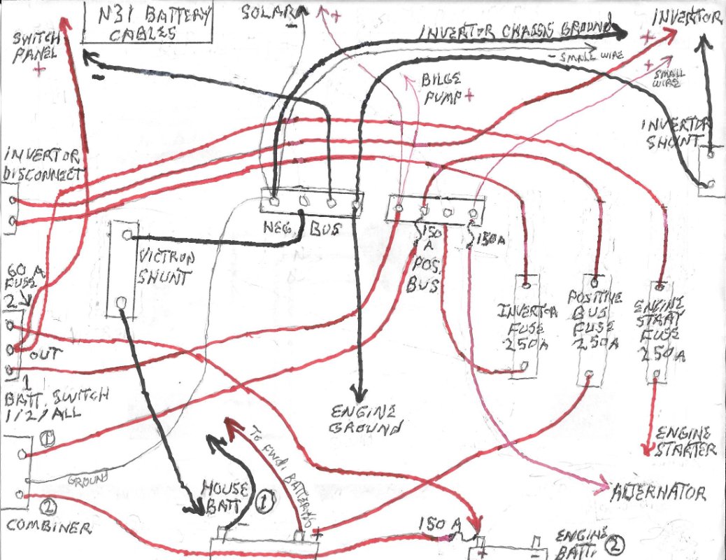

It's acceptable to have up to four wires per battery post but three or less is better, particularly when some need to be fused. To clean that up you should install positive and negative 250 amp bus bars near the house bank. I'm assuming you have two banks. I have a basic 12v electrics installation guide for a simple single bank boat that you should review:
https://www.youtube.com/watch?v=PofFOg9H_6Y
For a more complex two bank system I'll post some rough wiring diagrams below from a recent rewiring I did on a Nicholson 31 to show you how to set up the battery cables and main components. This boat's wiring is somewhat complex because of a 2000w invertor/charger, electric windlass, battery monitor and combiner along with loads of B&G electronics so hopefully you can keep yours simpler. On the drawing below I used expensive class T fuses for 250A and cheaper MRBF Fuses for 150A and under but you could use MRBF throughout. Fuses under 30 A are blade type ATO. The thin lines are light wires under #10AWG and thick lines are heavy cables 2/0 because we had it in stock but you could use 1/0 for much of it. Switch panel feed is #1.

Battery cables wiring.
