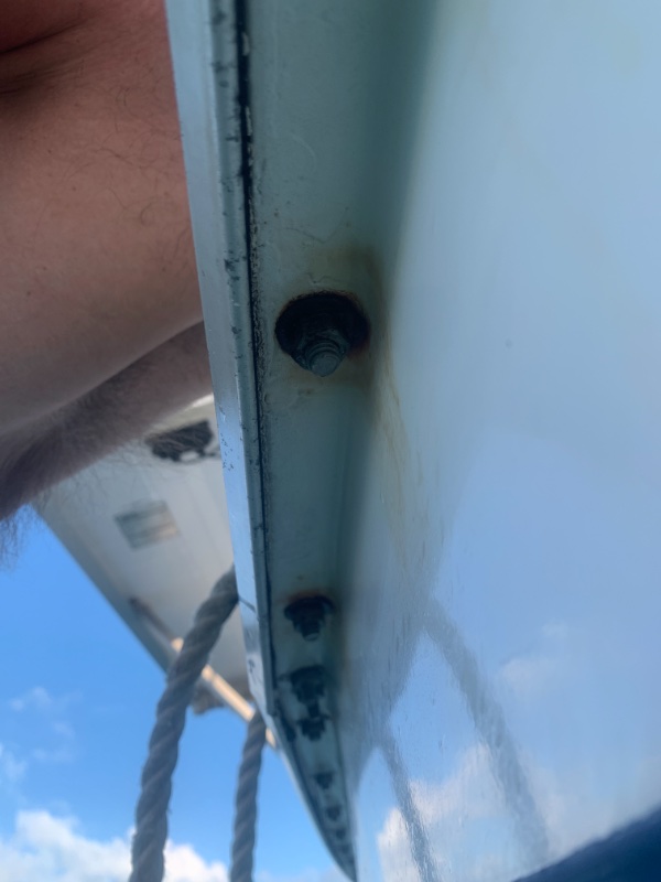

Very interesting thank you for the information. My other question about painting has to do with the toe rails. My boat has aluminum toe rails that through bolt on the hull-deck joint and I assume they will need to come off to get a good coating. As far as I know there are no leaks in the hull-deck joint so maybe it worth trying to paint up to
The bolts?
Here is a picture so you get a better ideal
Thanks again for helping with this
Logan
The bolts?
Logan
Re: How much awlgrip for topsides?
For best results in roll and tip you need to work fast to keep a wet edge. Painting that outward flange will slow you down too much so you might just paint the vertical portion of the topsides and not the flange or bolts. Looks like the slightly dissimilar metals of the stainless washers, bolts and nuts are going to continue to drip stains down the new paint. I'm not sure of the best solution to reduce that - maybe replace all three with 316 grade if available, or coat the washers with something like epoxy metal primer.

I just realized I can pull all the bolts out and there appears to be enough room just to roll out the flange. For some reason I was thinking all of the bolts had been sealed in with 5200 but I don’t think that is the case. I’m going to pull one bolt out and see what’s going on. I think you’re right about replacing some of these fasteners...for starters I have found a handful of galvanized washers.
