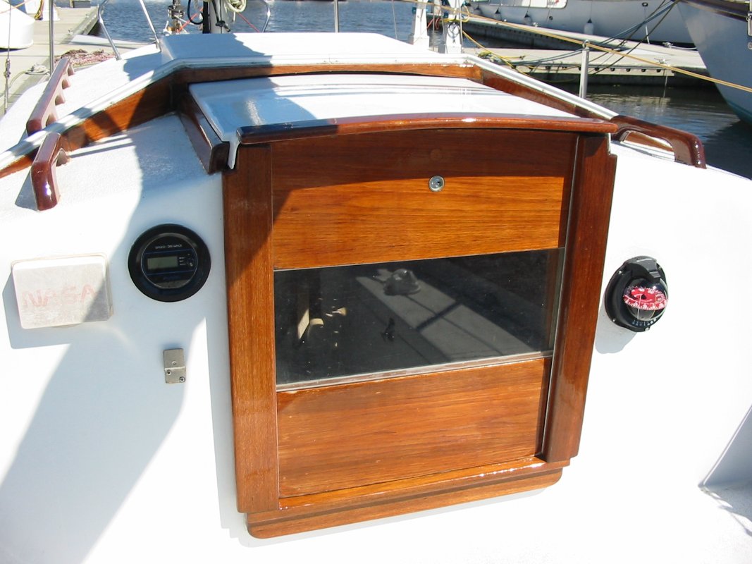

A30 hatch
A30 hatch
Re: Gasket for sliding hatch
You might be able to add a trim lip on top the sliding hatch that overhangs an inch or so to shed water as in the photo here, although I'm not sure if it will interfere with the current hasp setup you have. Otherwise, if your gasket failed at the glue joint, try using 3m Black Super Weatherstrip Adhesive instead of relying on the weak adhesive that comes on the gaskets.
