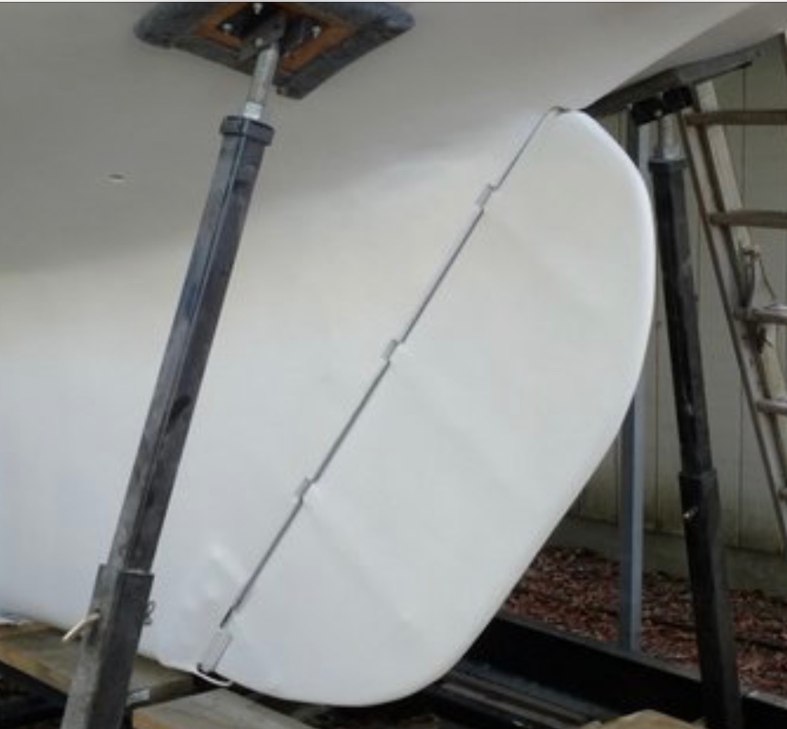

Is there any way you could measure the screw jackstands on your trailer in this picture?
Currently I have one piece of 2 in. square tubing welded to the trailer frame with the screw jack/pad (with washer and nut) on top of the tubing. The threaded rod is 1 1/4” galvanized.
I Measured my boat in the boat yard and set up the stands to those measurements.
I feel like it’s putting too much threaded rod up in the air, almost the entire 30” of the rear stand rod with approx 6” left in the square tube. (the rear stands have 30” screw jack lengths, the stands forward of the rear stands have 24” threaded portions)
I’d rather have two telescoping pieces of square tubing like you have on your trailer.
In the picture, I can see there is a square collar at the top of the upper telescoping section that looks like it is there to stop it from falling all the way through the lower section when it’s retracted.
Is there anyway you could measure your telescoping stand units for me on your trailer.
and I do understand that it takes a hitch pin with a cotter pin to lock it in place when it’s retracted down and also when it’s in the upper position.
It would be very helpful to have the:
dimensions of the telescoping unit (including the tubing size)
position of the holes drilled
length of the threaded portion of the pad assembly
angle of all of the jackstands
and the distance apart from each stand on the trailer as a double check

After looking closely at materials, it appears that the piece of square tubing with the collar on it is actually receiver tube. Receiver tube is perfect because it doesn’t have the welded seam and allows tube in tube to slide smoothly.
Re: Trailer Jack Stand Design
The upper telescoping tube diameter is 2" and the lower is 2.5".
The pin hole positions are three for each support spaced between 9-11" apart depending on overall tube lengths.
The screw pad thread length is 24" with 12" sq carpet covered 3/4" plywood pads.
The tube supports are welded to frame 66" apart aft, 64" center, 60" forward.

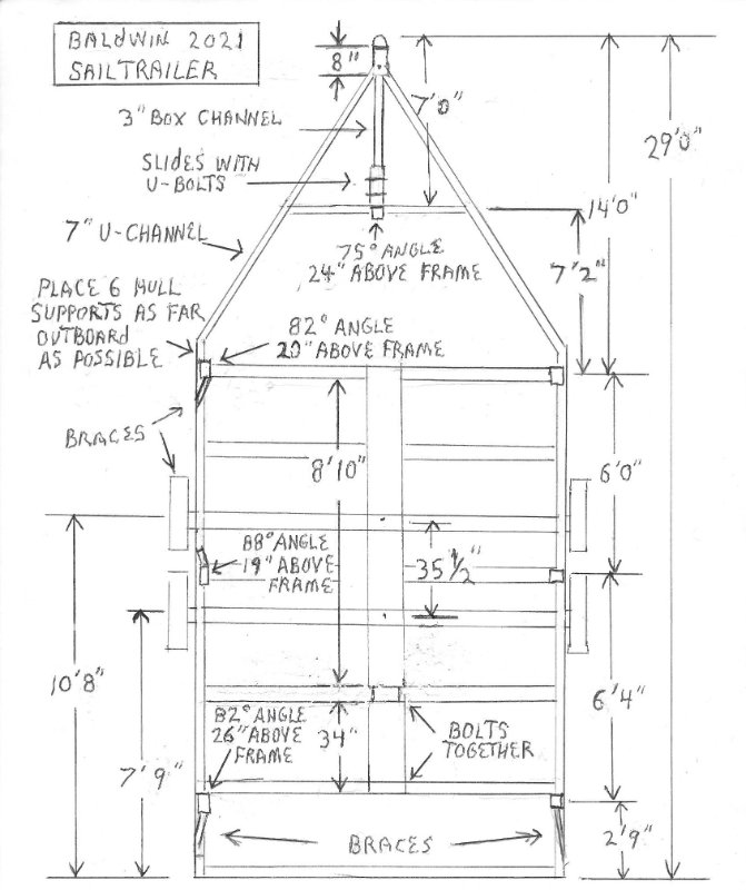

Below is a sketch of other dimensions and hull support angles that I specified to builder:
1. Tandem 6,000 lb (or 7,000lb) drop axles, both with electric brakes.
2. 12,000 GVWR construction, 7" channel, 2 5/16" ball.
3. 2,000lb plus fixed tongue jack welded to left front (not the lighter swivel type).
4. Lift-off type design with 7 extendable nesting hull support channels and screwpads with 3 pin positions spaced approx 10” apart. Aft supports to have a 4th pin hole 4” from the ends. Dimensions on sketch for supports are measured from top of outside frame.
5. V screwpad at bow on sliding base held by U-bolts with extending riser channel with pins like side supports instead of bolt-tensioning type because those can slip.
6. Removable aft frame section for rudder removal.
7. ST235/80R16 Range E tires or equivalent with spare tire mounted on welded bracket on right forward side.
8. Best available metal primer and black paint.
9. All galvanized fasteners.
10. LED lights with tinned marine wire.
11. Main 7” U-channel frames to continue forward within 8” of tongue for best support.
12. Treated wood for screw pads and bed.
13. Standard lock pins on adjustable hull support tubes (not bolts and nuts).
14. No side keel support boards needed.
15. 2x10 treated bunk board.
16. License plate holder bolted to left fender.
17. Shipping weight to be listed as 1,990 lb.
I forgot to mention that the 1.25" threaded rod slips into a piece of PVC tube about 8" long that happens to be a tight fit in the 2" steel channel. They just tapped it in with a hammer and it stays at the top of the 2" channel as a bushing. Since I didn't build the trailer I don't know if the builder had to specify seamless tube or a standard welded tube. I doubt he ordered anything but whatever was standard low cost. Welded seams are often close to flat anyway and may not interfere but you'd need to confirm that with the supplier.

Yes, currently the 2” square tubing section that is welded to the trailer is lined with PVC pipe with the 1.25” threaded rod sitting on top on a washer and nut.
Yes I've used this same trailer specs when hauling A30s. The trailer is designed for any boat up to about 31' and 10,500 lbs so the A30 is a good fit. Right now I have my 28' Triton on one and a Cape Dory 27 on the other same size trailer.
The aft two 2" square tubes are about 30" overall and all the others about 28". The 2.5" tubes are open at bottom. Fully retracted with pins out, the inner tubes sit up to about 2" below the bottoms of the 2.5" tubes and at times you may need them fully down to clear the boat on the travel lift because they may not be able to raise the boat high enough to allow you to insert the screw pads after the boat is above the trailer. I don't want the 2" tubes to be too long because if hauling a smaller boat one day with tubes fully retracted I want them to still have ample ground clearance.
Unless it's a short distance I always remove the screw pads from the trailer when towing empty although I doubt them bouncing on the pins would cause any problem.
Handle pins welded on the nuts are handy but are a snag hazard when moving around and working under boat so I use a pipe wrench instead. You could also injure yourself when working under them and then standing up.
Not sure how your total tube length compares to the measurements on my sketch of height of tubes above top of trailer frame. You don't want them too high for a small boat. The lengths I use are optimized for a boat with 4.5' draft and useable up to 5'. I would have an angle grinder and drill on hand so you can modify the tube lengths quickly if you find them too long when the boat is still on the travel lift.

The measurement for the 2.5” tube supports that are welded to the frame are:
66” apart aft
64” apart amidships
60” apart forward
where is that measurement taken from?
I want to double check and make sure I know where this measurement was taken from.
I understand I am measuring from one point then across the Trailer to another point, with the proper angle and length of the 2.5” base tubing.
Is it from the top of the tube or at the point it was welded to the frame or at the top of the trailer 7” frame?.
The distance between the square tubes was measured from the base at the top of the trailer frame. The distance apart is not really important as long as you place them as far apart as possible. Hopefully that will make them not less than the dimensions given. Ideally the trailer frame would be even wider and the bases a few inches further apart for our size boats to have best support. Since we can't get that then we just want them as far apart as possible and not angled in too far so that they don't give good support to the hull to resist side loads on the road.

Hi James,
Happy Summer!!
Well, the shed is completed, my mast is unstepped and I’ve nearly completed the trailer.
I’ve begun setting up the drill press to drill the jackstands…lots of holes and lots of cutting oil in my future. :mrgreen:
I’m getting sweaty brains around where the first hole should be drilled from the top of the 2” nesting sq. tube.
If I consider having the screw pad retract flush, then I think I should start the first hole at 24+ inches but that doesn’t compute for the three additional holes.
Also, how far from the top of the fixed tube support is your pin hole drilled?
I’m planning on your recommendation of 9 to 11 inches spacing between each of the holes, with 1” on the aft supports.
Think I’ll pause before I drill the first hole in hopes of hearing back from you.
Thanks,
Elizabeth

DIMs
Aft tubes at 30”
Amid and fwd tubes at 28”
And yes, my screw pads have 24 inch long threaded sections
What is the pinhole at 4 inches from the bottom used for? Is it just another Pin position at the extremis?
Cheers!!

On my trailer the top holes in the outer tube are 3" below the top. On the aft tube the inner tube has the hole 29" below the top. I'm not sure of the dimension for the shorter center and forward tubes but it's less. The holes near the bottom of the of the outer tubes allow you to put the pin in and let the bottom of the inner tube rest on it for an additional position option. Best for you at this stage may be to lay the tubes out side by side and look at different hole spacing options that give you the most range of adjustment without needing the screw pads fully extended.

I’m writing to thank you for your help in getting my my trailer build dimensions correct.
The trailer turned out beautifully, and the boat fit on it like a glove,
I set up the tongue weight with a scale and she towed smoothly with a few up and down wiggles I think, due to the tongue length not having to be that long.
She is a 66 or 68 Bristol 29…. still, not sure which year.

I’ll post a couple pictures
Thanks for the update and good to hear all is going well. Looking forward to see your refit progress.
