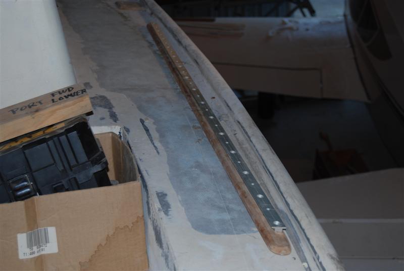

Re: Dan's rebuild with electric propulsion
Carbon fiber mast beam installed along with new forward shroud knee braces.
Dan

Well I think I located all the original placements for the deck hardware. I ordered a 8" bronze cleat for the bow because I only had two. I think the Triton came with one on the bow and one on the stern in the middle. I am not sure if the track was always right in front of the cleat or not but there does not seem to be much room for both. It looks like they were relocated to either side of the rear hatch. So now I have two that go there and one that goes on the bow.
I am not sure yet whether I am going to use the wood under the Jib track. It seems like a problem waiting to happen even though it would be nice to have it of the deck. Any opinions in this area would be helpful. I also have 4 Wichard pad eyes that have not been installed. Are these better than the triangle type and should I use them in any certain place.
I found some bronze bushings for the grunions so once they come in I have both the pintles and grunions rebuilt they turned out rather nice. The false keel is half done (one side) a vacuum cleaner on the sander helped a lot. I filled in the holes for the grunions plus about 1" with epoxy. I think this is a weak spot on the Triton. I think that is where the water gets in for the false keel. I am also going to use a piece of carbon fiber on the bottom and extend it like Tim does to cover the rudder. I would rather use carbon fiber than a metal just in case it gets hit it will break rather than bend and interfere with the rudder. The new rudder is laminated up and should be ready for construction tomorrow.
Dan
Dan
I don't know why you are considering wooden (or any) pads under the cleats, so I can't comment as to whether I would do the same thing; but, if I were going to use them, I would probably either use pads made of pre-made fiberglass board, such as you can buy from McMaster-Carr, or maybe bare teak (I don't like having to varnish small pieces in places like that).
Oh, I wanted to add: This is just me, but I would change up to 10" cleats. Even with a pair, I like the extra size for its ability to easily handle more/larger lines when necessary.
And... nautical terminology (always fun :) I have never heard the term "grunion" used for "gudgeon" (which is what I am inferring from your post). I would like to know more about that. I'm thinking that it is either a nautical term I don't know (of which there are many), or that maybe it comes from airplane terminology, since you are an aircraft afficianado.

No that is just my mistake I have not seen the word "gudgeon" enough so I just keep forgetting it I just want to call them hinges but I know that is not right either. I will write it down so I have something to refer to next time.
The wood is from the former owner. It goes under the Jib track not the cleats. I still do not know if I want to use it. Just like you, it seems like more work than it is worth. Well that did not come out right but you know what I mean. All the other pads are made of fiberglass and bought by the previous owner. No pads under the cleats. Only the stanchions, pushpit and pulpit, (Mid winches, clutches, and organizers) these I may not use. I liked the idea of raising things up where the water ran along the toe rail.
I could use the two 8" cleats on the mid sides I suppose. Would they be of any use there?
Dan
Dan
There may be spacers under the tracks for good reason (or not). Do the cars need the clearance?
I look at that genoa track mockup with the wood raising it so high, and my toes just say "ouch". Genoa tracks are bad enough toe-stubbers as they are. I wouldn't use the spacers, but that's just me.

Along the same lines, I would not do the wood under the tracks. Leave them flat on the deck so you can step right on them without a thought.... or put them up on the toerail.

carterskemp
- Posts: 54
- Joined: Wed Sep 23, 2009 9:57 am
- Boat Name: Hali'a
- Boat Type: Pearson Triton #345
- Location: Bristol, RI
as for the jib tracks, why not just mount them directly on the rail? mine are similar looking tracks that are straight when unmounted, but then with the help of an assistant mount directly onto the rail. curved and all.
gets them off the deck and makes one less thing to jam your toes on.
