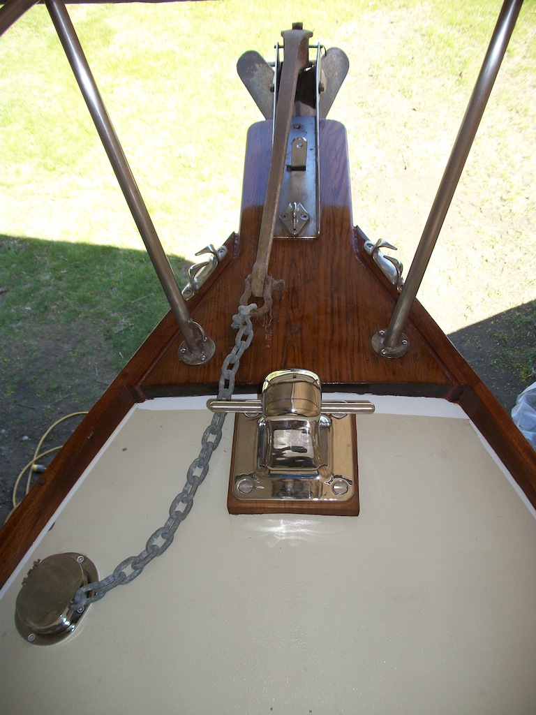

Here's a picture of the installed bitt. I went with stainless steel because the bronze bit (in the size I was looking for) would have been backordered with a 6 to 8 week delivery schedule.
The stainless bitt goes well with the rest of the deck hardware and I like its looks too.
There is a 1/4" aluminum backer plate a little bigger than the teak mounting board. There's no way this thing is comming loose from boat unless the whole fordeck goes with it.

Re: A bollard, a bit or a cleat?
Just think how well you will sleep!Gary wrote:There's no way this thing is comming loose from boat unless the whole fordeck goes with it.
Me likey!
Makes me want to do something similar with mine.
Right now what I've got is two mis-matched cleats up there. One large-ish one and one medium-ish one. And I haven't ever really taken a good look as to how they're mounted. After reading all this, you've done an excellent job of raising my paranoia level, so thanks for that.
But yeah, that one big fitting there looks neater and more secure than a mish-mash of a couple different cleats.
Sigh.... yet another project to consider...
