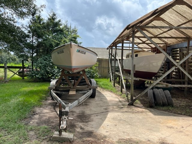

Also found this one of how I hauled it to the farm from the Yacht Club;
Sixteen foot flat bed trailer with a two by four cradle.

I like the innovative trailering solution. :D I've thought to do similar with my Ariel for long-term storage if I took off on a trip on a bigger boat, or to take her cross country in lieu of sailing thru the western Carib and making a Canal transit. :D

The flat bed trailer was just a quick, cheep way to get it home. I have since bought a galvanized power boat trailer that I plan on converting to a sailboat trailer. If and when I get to that I will post the work here, also.

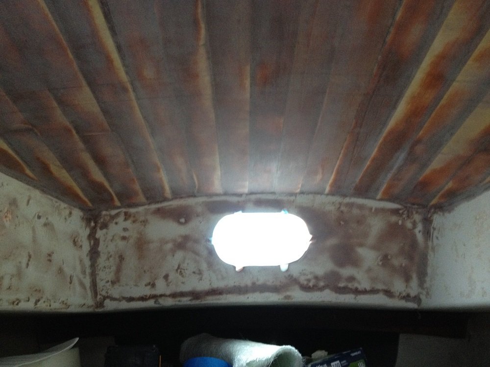

Before I put the mast beam in, I figured out that the core in the cabin top was wet. I cut a hole to check it out.
I then cut all the inside layer of glass out of the cabin top. The mast beam I made has been set aside for now.

It's been awhile since I posted anything so here is some work I did back in May 2021.
This first picture is how I held up the biaxial cloth I put up on the inside of the cabin ceiling.
Epoxying in a new mast beam.
Close up of the port end of the new mast beam.
And two layers of biaxial cloth on the mast beam.
Epoxy fairing inside the cabin top and mast beam areas.
And the area sanded out, ready to paint.
Fitting new lexan into ports.

I cleaned out a path so I could pull the boat out of the barn.
I parked her beside my Bristol 27 shed.
I got her out of the barn so i could start working on a mast raising system.
I ran into a snag on galvanizing the trailer parts that I built. The local galvanizer closed up and the next closest one is three hours away. My truck started messing up so it is in the shop. I hope they can get it fixed so I can make a road trip to the galvanizer soon.
