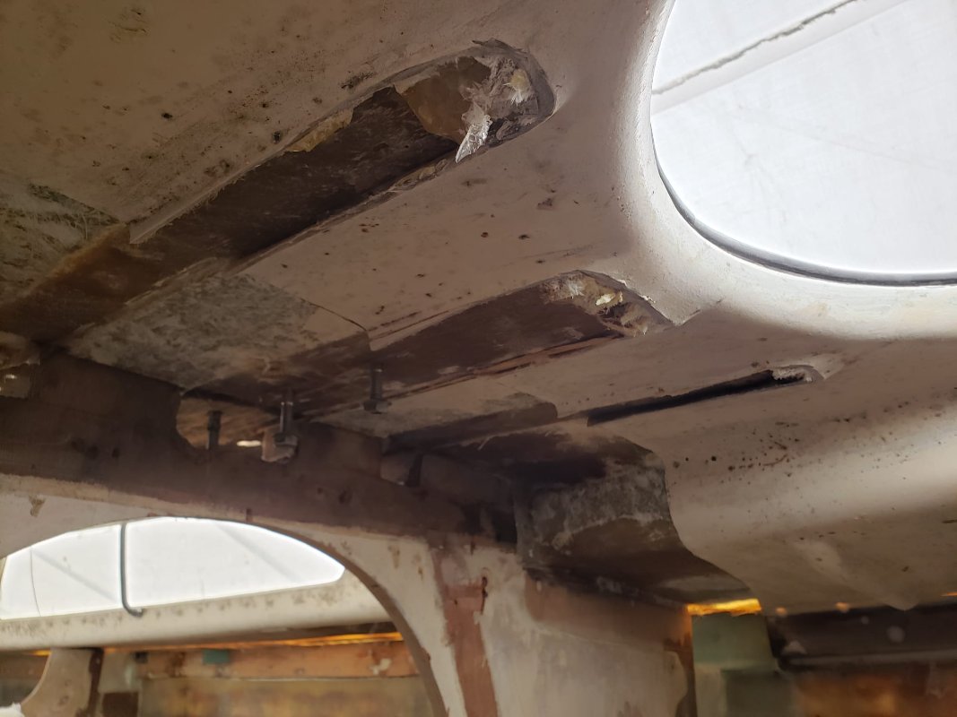

the keel bolts look new.
if it wasnt for the condition of the nuts, washers and end top portion of the bolts, this whole step would have been have been avoided.

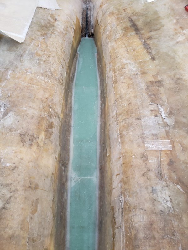

bilge floor, before and after
did a couple of straight epoxy pours to level most of the surfaces, then applied thickened epoxy beneath the 6mm thick G10 sheet., finally one layer of biaxial cloth was laminated on top.
need to knock some peelply bubbles, fair some rough spots and on to paint.! will dril the keel bolt holes from outside

what you see here are a couple of plywood stringers that help stiffen the hull.
these are original and the plywood is moist and delaminating specially at the top. i cut them in half, height wise, to check is they were sound. and turns out they are not so bad so im keeping whats left because the whole thing is still firmly attached to hull. i will be glassing over to reinforce and help spread the loads.

....whilst the fairing cures.....
decided to glass over the entire main bulkhead.
was a good boy and actually used the orbital sander as opposed to the belt one.
before after
before after
