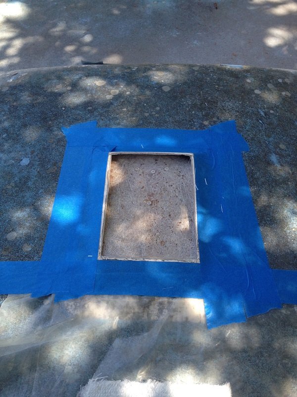

Before I put the mast beam in, I figured out that the core in the cabin top was wet. I cut a hole to check it out.
I then cut all the inside layer of glass out of the cabin top. The mast beam I made has been set aside for now.

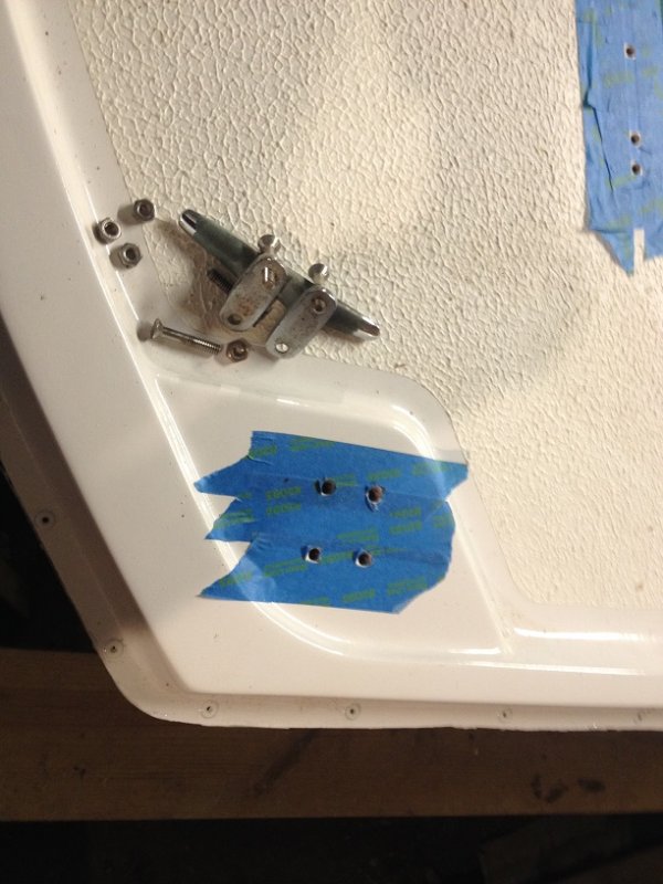

I managed to get all the deck hardware off the aft deck area. Except a track end stop which I couldn't get a nut off of. i needed another set of hands for it.
A lot of holes to fill and redo. A few of the pieces will not be put back on, fishing pole holders, flag pole holder, life line end brackets and I think some boarding ladder brackets.

This is the last patch of old cabin top glass to take out. It is on the starboard side, aft corner.

Next I got the old wet core cleaned out. Sanded the underside of the exterior glass.

Deck taped off for nonskid. Two cockpit hatches taped off. And a close up of a cockpit hatch. And a picture of the aft deck taping. And the cockpit area. The nonskid on the aft deck. A close up of the aft deck port corner nonskid. A close up of the cockpit seat and hatch lid nonskid. And a last one of the cabin top nonskid. So now the nonskid is all done.

Still repairing the combing boards. Filling with epoxy.
Sanding old varnish off two interior trim pieces, getting them ready for new varnish.
I cut new companionway trim out of PVC board stock, the old wood was to far gone to reuse.
The starboard aft deck cleat holes, drilled, refilled with epoxy then re drilled ready to install it.
And installed.
The fore deck cleat, ready to be installed.
