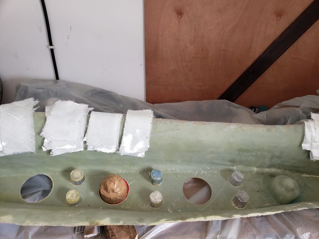

quick update about the rigging
vectran covered with nylon/polyester sheat, whipped at both ends.
this will be further covered with Marlow dyneema hollow plait chafe protection sleeve.

Ah hah! I was wondering how you terminated the line... then looking close at this part I see you are making a small eye splice over this metal plug (for lack of the proper term) which I've highlighted with a yellowish color, and that fits inside the terminal - is that correct?

Re: Introducing Katie-J
yes, thats it!
they call it the bone and is does look like that, very smooth little piece.
the eye is done as snuggly as possible

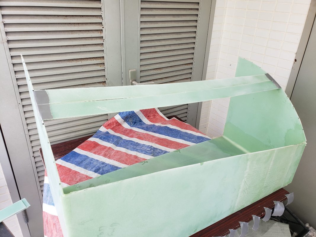

trying to keep things ticking forward since i cannot work on the boat due to weather
Been designing a composting toilet, based on the C-Head shape
Its pretty much a copy of its overal shape, but im making sure its churning mechanism is way more complicated, so im going in the right direction! hahahaha
solids bucket its an off the shelf unit (5 gallons)
pee container is designed by me. 4.3 litre (1.1 gallons)
toilet seat shaped to the toilet, unlike the C-head design where they´ve maintained a curved shape, making it weird in my eye.
the toilet is going to be built of 3 mm G10, epoxied and glassed

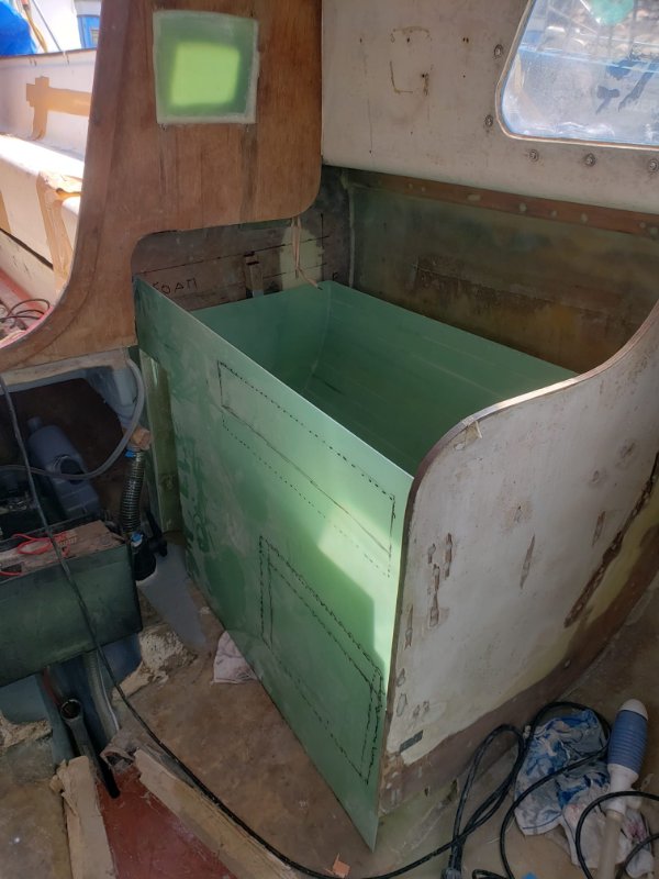

And been designing the fridge/freezer box to eventually accomodate a CoolBlue units.
Got it to 7.3 cubic feet, approx 200 litres, which is the advised size for a fridge/freezer single system.
this size account for 4 inch insulation on the hull topside face, and inside face, 3 inch from the top, and 2 inch at the fore and aft face.

Re: Churning mechanism - I've been pondering variations for years. How does/will yours work, it appears to need to have a hole in the bottom of the solids container...?

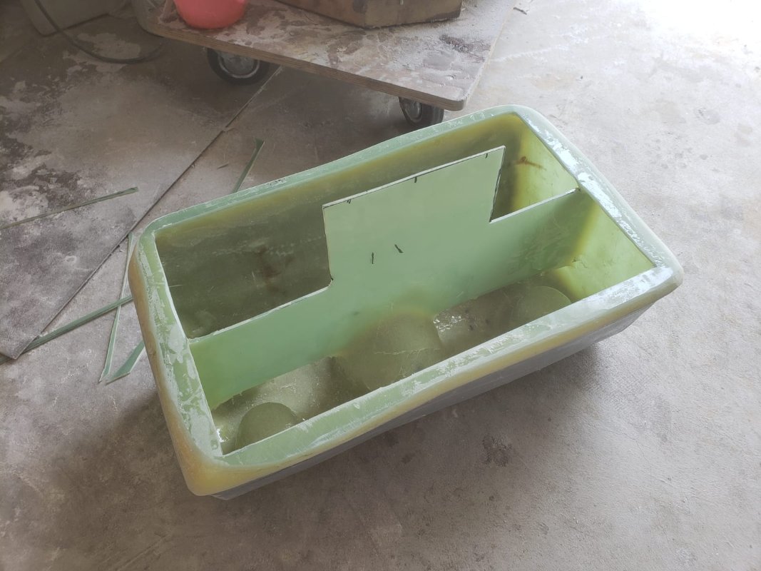

i will apply grp cloth to the inside of the bucket, having previously applied in place a piece of plastic which will make up for the volume , occupied later by the central sprocket,
this way, when i effectively cut the bucket to make way for the chain connecting both sprockets, all solids will be contained by the grp lining. there will be a 50 mm difference between the lower sweep height of the churning paddle and the bottom of the bucket, but i will fill that with foam and glass it. will lose a bit of volume but im ok with that. ie, i will be raising the bottom of the bucket.

Looking forward to seeing more of the churner.
I've spent many hours trying to figure out how to do one that works horizontally, as that would seem to be the best way to make it churn most. Lately, though, I've been not churning, instead just giving any new solid deposits a light dusting of coir. That actually seems to work well.

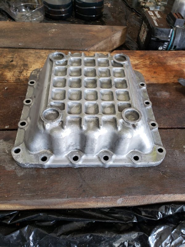

oil sump before paint stripper
after paint stripper

trying to move forward in the bilge tank project
was able to glass some bolts pockets
big pocket before big pocket after the big pocket will need some fine tunning as there is some excess material. this happened because the mould was being used for the 2nd time and the shape wasnt perfect. (will be using new moulds for all the remaining pockets)
Aniway, all pockets will be slightly rounded off on the exterior so i can laminate one layer of cloth to bind everything together. i dont think it would ever be a problem if i didnt glass on the outside but this way i know its pretty much bullet proof.

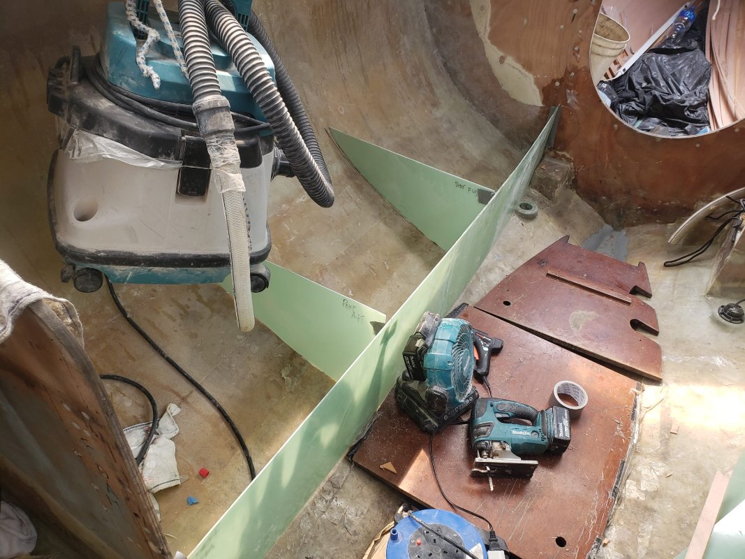

keeping on the bilge tank
did a dry fit with after all the bolts holes were glassed after that i used some thickened epoxy to glue some partitions in their spots, enough to remove the tank from the bilge and cut it into their final sizes glassing these first partitions in, it will take some more layers to achieve enough of a thickness that can be rounded and still retain enough integrity
after laminating the side walls, and taking the smaller tanks to the boat again i got a reference line (it was all very scientific measurement with the cap of the marker i was using) and i cut the tank all along its perimeter.
then i went really scientific again and halved that distance to obtain a second line where i will be glassing a support frame. you wont see that line because its hidden by the jig i made with plywood strips to get the shape for the frame.
i glued the corners with hot glue and faired whatever needed fairing for a close fit.
with the frame in place
so why all this?
in order to round all edges i need the presence of some material that i can grind/sand. i have that material along all corners of the tank apart from corners formed by the lid, its just a matter of laminating some more glass, give it some thickness and then i can safely grind from the outside without losing integrity.
for the lid i needed to create that thickeness and for that, those frames will be glassed in and a some thickened epoxy will be poured from the inside (with the tank at an angle). having that frame will also help to glass the lid.
i used the marker's cap (misplaced the tape measure) to have a reference from the bottom of the cabin floors to the top of the tank to make sure i have enough space to glass a handle which will enable me to remove and place the tanks
it will make sense in the coming posts

cracking on the bilge tanks
epoxy pour on the long side of the tank
this process will be repeated for all 4 sides on all tanks since i have the frame firmly secured, even though not all corners are filled with epoxy i can now show the baffle/handle solution i came up with
the protuding bit size is based off of my hand, oversized, then a slot was cut on the tank lid which will be glassed later on
the slot cut was a bit too long but i can fix that from the inside the 3 tanks so far with a rough fit for their lids

port and stb bunks building
been butt joining 3mm G10 sheets to make bigger sheets, from which to cut the partitions which will become the side bunks everything is still very rough and needs tweeking to get the lenght right and that its all level and true
the next step was to mock up and cut the sub partitions for either side (which i did by templating with ply strips and hot glue).
divided the available space into 3 equal parts and cut the G10
only port is shown but stb is also done
next piece was a long time in the making.
its basically the only piece i kept from the initial interior demolition: the partition which created the enclosure where the water tank was placed, and also separated the engine room from the pilot/quarter berth.
i kept it because it would save me time fiddling about with thin ply strips to get the shape & dimensions right for that piece.
it will still separate the engine room from the rest of the boat, but it will be one of the actual walls for the integrated water tank. it will also be the inside/interior of a new cockpit locker which will be created later on. some will notice ive extended one of the edges so i could end up with a bigger volume
next photos depicts something ive laminated a couple weeks ago as an experiment.
i got a lenght of 4 inch PVC pipe and laminated grp completely around it. it came out great, easily detached from the packing tape.
the idea behind it was to see how it would fare if glassed to the bunks partitions, and water tank wall, in order to go around either the thru hulls and ball valves
the objective is to halve it, glass it to the G10, and after curing, cutting the G10 sheet to open the space bridged by the round grp piece.
you can see here that the 4 inch diameter aint going to work. it is just to "tight" and i think when the time comes to deal with ball valves and thru hulls one i want to have space to spare to rotate things around, use tools, etc
its a perfect fit around the thru hull but i end up with a very confined space to work i guess the next size up is 6 inch in diameter and thats what im going to laminate next, im confident it will be enough

lets build a fridge!
sometime ago i posted some cad drawings showing the ice box which will house the fridge.
i then had those drawings printed full size on a plotter, cut the paper and transfered those shapes to the G10 sheets
after cutting it i assembled those pieces with gaff tape and inittially only wanted to spot weld with epoxy. the tape hold was so good i deemed it enough to apply a fillet and laminate some cloth on top making sure it would accomodate the pressure of the lamination roller when the time came to cinge everything together.
measuring the cloth glueing and laminating the round wall was done by strip planking it with 2 inch ish wide strips of G10, taping it to the side and to each other.
the gaps were filled with thickened epoxy and a single piece of biaxial was laminated on the interior i ended up having to fit a steeler plank on the bottom to close the box the whiskey plank as they call it! interior lamination outside lamination the idea now is to laminate a shelve on the interior but after some thinking ive concluded that i need to have a mock up of the holding plate i will be installing in the future. i also need to dry fit the fore-aft galley wall which will determine the final position of the fridge box in the available space created by that wall. if the box shifts position inside that space it means the top sheet, thus the acess lids, will also shift. and all of this also means playing with the insulation thickness....
interesting and no doubt, comprimising, times ahead....

"nobody is perfect"
i guess this one is pretty much self explanatory ahahah it did came thru the companionway, but i got effed by the main bulkhead,
i guess that i bent the template too much when it was getting it out the v berth.
it was 4 inches too big at the widest point it seems. everything is getting tabbed and laminated so in the end it will make no difference.

took the fridge box and galley wall to boat and made a dry fit of both to check clearances and space available for insulation
it was more of a balancing act but it actually went pretty good
first the fridge box goes in then the galley wall this was a good opportunity to have a better feel about the engine compartment door final position and how that would affect the location of storage on the galley wall
checking the ballvalve clearance checking the space for some storage and how it would affect insulation thickness overall view
