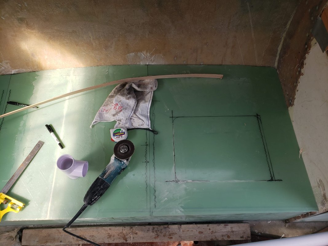

got a few hours today to get around some templating, cutting and rought fits around the STB berth
sketching up and cutting up the straight lines with the angle grinder and finishing the corners with the jig saw with a metal blade
first opening cut and used as a template for the other 2.
it was centered in the middle and them scribbled the contour around
all 3 cut

onto the G10 sheets
rough initital fit
had to recycle the ply strips from previous templates, they add up quickly!

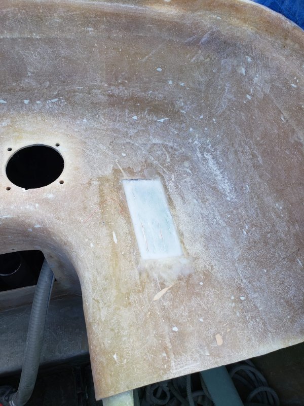

decided to remove the instruments and close their respective holes
before
after
i actually made the holes slightly bigger with a 4 inch hole saw, because it was the only one i had in hand to then cut the G10 round pieces. despite using 2 x 6mm pieces for every hole im still not flushed by a few mm. the fairing filler will do the job.

some spots to be filled (they have never been filled from new), just before i laminate a couple layers on the underside of the cockpit floor

marking the new access hatches onto the floor

in order to cut the hatches i had to cut the reinforcing elements,~that run atwartships, one of the them being a SS corner piece which was in great condition. im leaving whatever is original and still firmly attached to the floor, because it is actually still performing
you can also see 2 black lines, representing the future vertical walls, in (6mm G10) which will separate both lockers and support the whole floor

dodger build
peelply removed
demoulded
all the underlying "structure".
yes.....what a mess. you can see how i was using those bags as stuffing agents
refitted after structure removal
fairing application
i used more fairing that im willing to admit and i know that im applying some more. lets give this a chance to cure and see how it fares (pun intended)
this alexseal stuff is pretty expensive but really nice to work with, no sagging at all even if you go 15 mm thick (which i did). I had a test done months ago when i did the hull, i had some mixed leftover and i applied it on a concealed part of the cabin (have to remember to take a photo) just to see how it would react if you slapped a stupid amount of it.
Not only it cured rock solid, as i then cut it with a jig saw and it gave me a clear cut. Obviously this isnt a structural filleting product but i knew from the test that if you are to use it as a fairing agent and then laminate over it you wont have any problems, even if you go 20 mm thick.
a better shape (than it was initially at least hahaha)
overall look
you will notice i didnt apply fairing all over it. it would be a waste to do it on the window area.
the goal is to get a shape im happy with and pleasing to the eye
