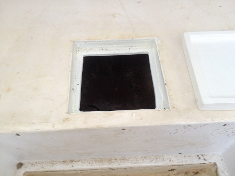

I built up a wood base for a battery. I got it all coated with epoxy. This is where I am going to put the battery. Just aft of the V-berth bulkhead. I set the base in with thickened epoxy and tabbed over both ends. I bought a small battery then made some cleats to hold it in place. I got them coated with epoxy. The plywood board, in the picture, is for a opening in the V-berth. Then epoxied the cleats in place and put the battery in. I also got it wired up. Here is the opening in the V-berth. More to come.

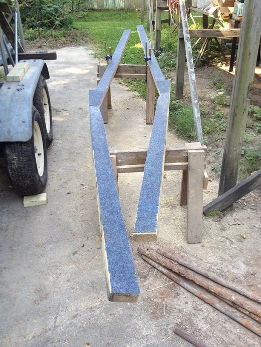

So I had a problem getting the 2 x 4 bunk boards on. I glued carpet on the tops of the bunk boards then started to install them. I was only able to lag screw the boards to the back three uprights brackets. The back three basically line up straight. I couldn't twist the front ends of the boards in enough to screw them onto the front upright brackets. I thought I had worked through this problem when I was making all the uprights. To much time had passed to remember what I had done. So I decided to try to persuade them into place.
You can see in the above picture how close I was to getting them into place. Well the next morning when I looked both of the boards cracked just past the second upright. Oh well.
On to plan B. Yep, I cut out the crack and epoxied/screwed them back together. No bend needed now.
I think that gets me up to date.
Tomorrow I will glue a piece of carpet on the splice area then lag screw the bunk boards into place. I hope.
