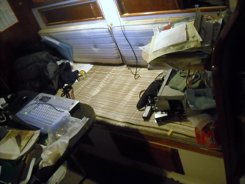

here is a picture of the area i want to change, and yes, i know its a mess. I did a sketch of what i want it to look like, but its at work right now, I'll post that when i get back on Saturday. I did find out that an average double sink of decent size is about 33" long by 18" and 9" deep, plus plumbing. That would leave 38" for a "desk" and a 1" divider. i am thinking about opening the area under the sink up for a bit more leg room, not much, just the last 6" that would make it more comfortable. i am fortunate that i am only 5' 10" and my wife is 5' 2" so we do not need an extraordinary amount of room to make this work. As i have been thinking about this more, i am wondering how would I construct it? would marine plywood sealed with epoxy and painted do well? or do i need to seal it? what paint should i use? Should i keep any of the fiberglass Liner in that area? design is fun and relatively easy, how to make that a reality, that is a fun part. thanks for the advice
Regards,
Jordan
Regards,
Jordan

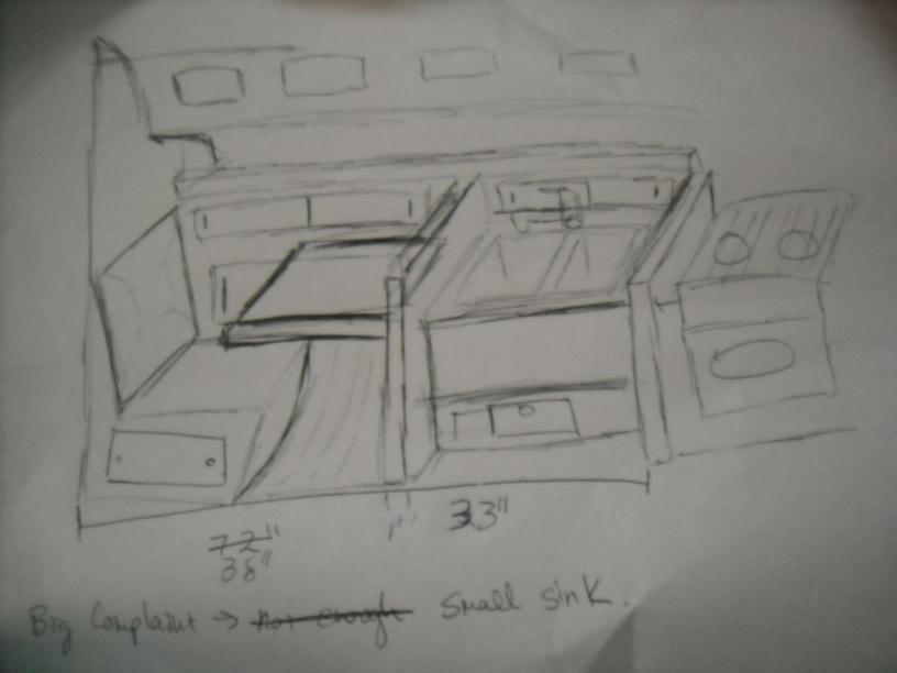

The design below is what i am toying with since the current sink is only 14" x 10" and 9" deep. The big problem that would be a real pain in the butt would be the drain. I have a thru hull underneath the sink right now and ideally i should put a new one where the sink is supposed to go, but the boats not going out for bottom paint until next year and that is a project a bit beyond me right now. Is there a problem running tubing, 1 1/2" or 2" of course, roughly 7 ft from the drains? too bad i'm not doing it to the port side, i have a thru hull there i'm not using from the old head(converted to composting head and capped the thru hulls, haven't filled them yet) but that is the longer settee and it also converts to a double berth as well. A few bonuses would be removing the old sink and replacing it with a top loading pantry and also the area the new sink will go in is 20" above the current settee bed and since its only a 9" deep variant that will open up the area below it for pots and pans and more food storage. there is quite a storage issue on this boat, especially with 2 people onboard. Lastly, how should i do this? just cut out the liner and put in some sealed and painted marine ply to make the wall and foot rest and install the countertop on the fiberglass liner? suppoerted of course, but stil, i am suspect to whether the fiberglass liner can hold up. Thanks for the examples and encouragement so far! i am pretty positive i am gong to do it. But i need to get good plans and look at it fully before i leap into cuts. thanks again
regards,
Jordan
regards,
Jordan
