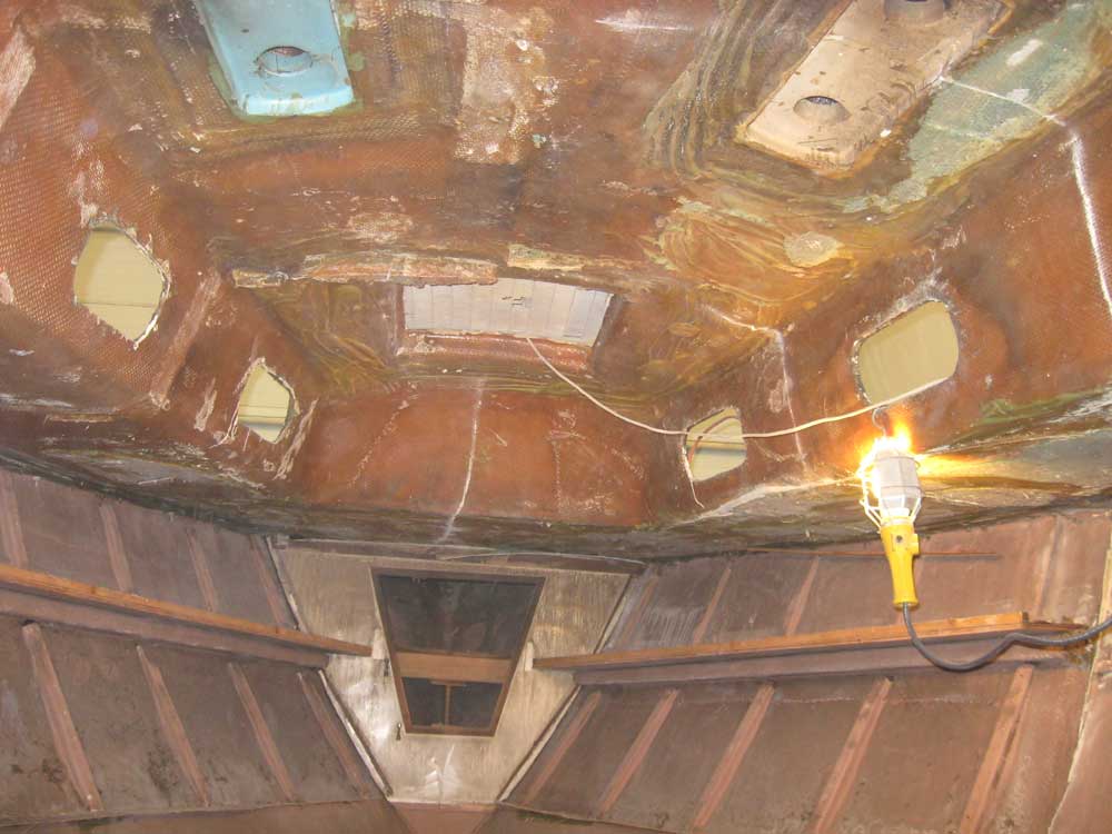

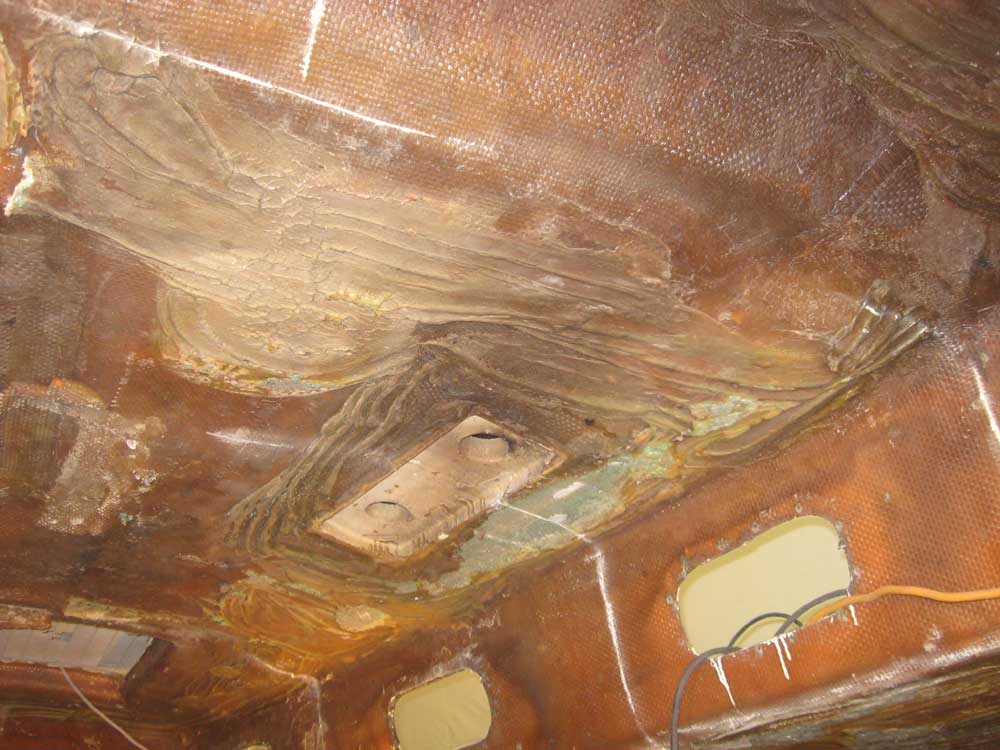

Beware that beneath that liner it might look something like this. These molded interior liners are secured with who-knows-what sort of globs of gunk, which is extremely difficult if not impossible/impractical to remove to a smooth surface suitable for painting and liveability. I know I'd never be willing to put in the work to smooth a disgusting mess like this to something worthy of exposure.
Unless your liner is in poor condition, leave it in.

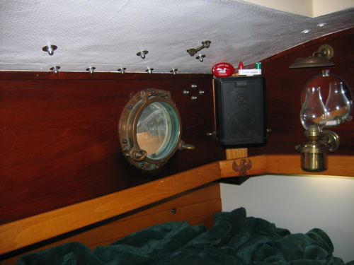

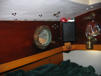

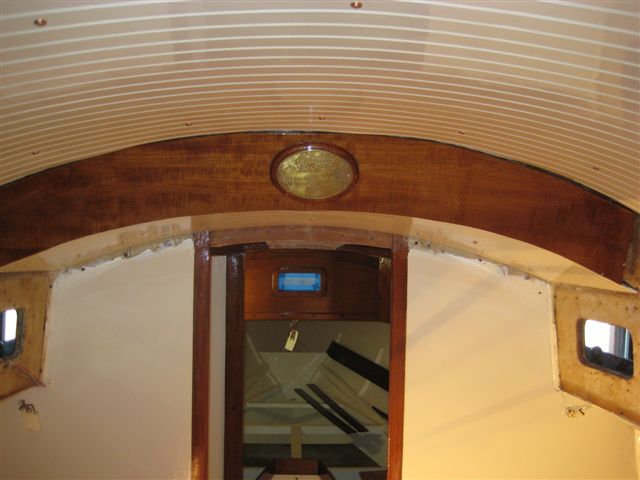

I have been very pleased with the results of covering the bare fiberglass in the cabin roof of my Cheoy Lee Frisco Flyer with a good quality hardwood beadboard painted an off white. I attached it to the raw fiberglass using brass round-headed screws and finish washers so that it could be dropped if needed. The finished look is very "Herreshoffy" I will try and post a photo if I can fiqure out how to do it.
Falcon

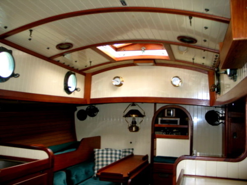

New Headliner
Cheoy Lee Frisco Flyer "work in progress"

I like that beadboard look. I'll have to make a note of that for my own headliner replacement.

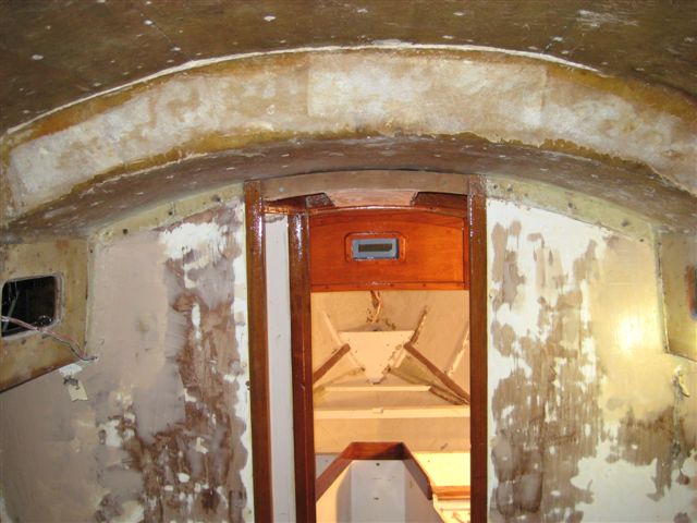

Chiming in here, I'm not a fan of liners of any kind. Granted I don't know enough about a bristol or triton to know how they are set up but for me seeing the fasteners is extremely important to me even over looks. Of course I don't think I sailed on a boat with a headliner until just this year. And when I did the owner was asking me how to fix this or find that leak all of which were somewhere under the liner.

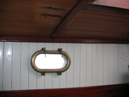

I removed my liner during my rebuild which was 1/4" pine slats running fore and aft attached under with 1/2" plywood screwed to the underside of the deck. Also notice that the idea was carried to the cabin sides as well. 4 of my 6 portholes had rotten cores around them because, 1. the core was not protected when the portholes were installed and, 2. although I knew there was a leak somewhere it was next to impossible to track down what were leaking. The water didn't just drip right underneath the porthole but about 3 feet forward of this position where I was concentrating the search. Only after all of this came out did I figure out what was going on.
Some of the older BCC's have this kind of liner. Just about all now have a pieces of gelcoat paneling that looks a lot like the pictures from Falcon or jhenson. These gelcoat panels are not cheap. I paid $375 for a 8'x8' panel from Cape George Marine works in Pt. Townsend WA. If I were doing it the same way the boats came factory I would need something like 5 or 6 of these pannels to get the whole boat done. They look nice and you can see your mounting bolts though it. You cannot, however, put any insulation if that is something you want. I would glue it into position using several cheap shower curtain rods to hold it while the epoxy/polyester cured.
I decided to only cover my bulkheads in the galley and salon with the panels so I only have to buy 2. All of the other areas I have ground smooth and I am currently sanding a microballoon filler that is under the cabin top and cabin sides to accept paint later. As Tim stated earlier with pictures etc. it is NOT an easy job to get the area ready for a smooth paint job. You can only work so long above you head. Every time I sand I make it a point to do a little more on the overheads for about 15 minutes.
The picture below is another BCC that didn't even try and just painted. You can easily see the fiberglass weave. Some people think it's ugly, but the rest of the boat has such beautiful wood work that you really don't even notice.
Good luck in what ever you choose!

Ripping out molded liners is great if you have plans to put in something cosmetic to cover the raw laminate beneath. I'm no fan of molded liners.
However, that's really not what the original poster was asking about.. It sounded to me like he wanted to remove the liner and not put anything back--just paint the exposed laminate. This might work if one can live with the appearance of painted fiberglass, and there are sound reasons for not wanting a liner of any type, but it might involve lot of time-consuming and unpleasant work to smooth the exposed laminate to something even a true back-to-basics person could love, if it looks anything like my pictures above (probably a worse-case scenario, but still generally representative of what things might look like beneath).
Here's another example of what it could look like beneath a liner. In this case, there were numerous blobs of resin holding the liner in rather than the heavy beads in my earlier photos. Still, this was a lot of work to clean up, even though it was ultimately invisible in the finished interior. It would have required even more work to bring to anything approaching an expose-able finish on its own.
There are as many different ways to cover a raw laminate as there are boats, but that's not really addressing the original question. The question was about whether no liner was better than the existing liner, and what pitfalls might exist with either choice. Having no liner at all can be great in terms of fastener access, but only if one can achieve an appropriate appearance given what exists to start with, and based on one's own expectations for how pleasing the finish might be.
In any event, one would be wise not to underestimate the amount of work it might require to remove and then rebuild a suitable interior liner or other finish, and this should always factor into the ultimate choice.

That picture Tim, is pretty much exactly like the deckhead of my boat after I took out the interior liner, I've only sanded the blocks away where I've needed to access the deck hardware. (They covered all the nuts and washers in it as well)
Probably one of the most frustrating practices to deal with on my boat!
