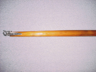

That's my spinnaker pole in the first photo you posted. It's the same as John describes with a lot of camber in the taper from 3+" to 2" on the ends.
I have seen it with an alarming bend once or twice but it has survived. I could see during those bends, the taper was well thought out.
The compression from a symmetrical spinnaker can be substantial. If you do intend to use it more as a whisker pole, you will not likely see the same loads.
The photo doesn't show the taper which in fact is quite visible.
