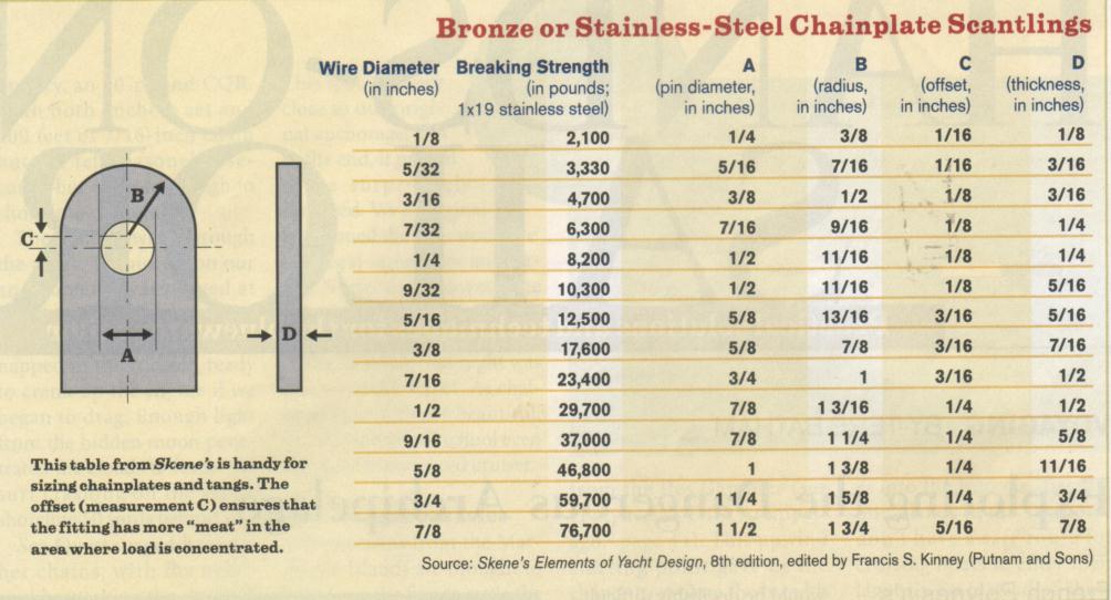

Sizing goes by wire size, and here is a chart from Skene's Elements of Yacht Design, 8th edition, edited by Francis S. Kinney, for guidance:
I don't believe there's any harm in the chainplates being larger than necessary (unlike, for example, the rigging wire, which you want to keep close to design specs).
PS: I'm not sure if it's okay to post this excerpt from Skene's here? If not I could come back and remove it and just type in the sizing information for the Triton's wire size (I wasn't sure what size it was or I would have).
