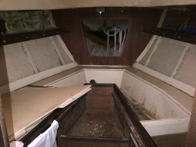

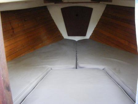

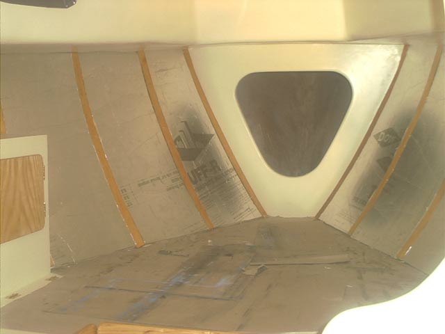

Here are a few pick of my V-berth from before and as of today. I am going to make it more habitable as the wife would say. I am also going to remove the watertake cover, clean and inspect the tank the tank.
before.....
before.....

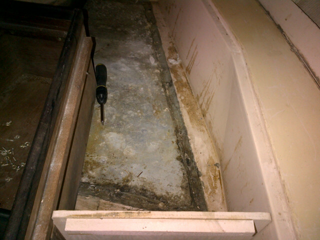

this is the top of the tank...can only imagine whats inside!
Any and all ideas and pics would be helpful of what you have done to your v-berth. I am going to add a cover to the chain locker, LED lights and fresh paint. I am thinking of adding boards "slats" to the stringers on the lower portion of the v-berth that is common on alot of boats i see. I am also going to add a foot water pump to the water tank plumbing. I will keep you posted on the progress.
www.svsalacia.blogspot.com
Preparing to get underway!!
Re: V-berth & watertank refurbish
Thanks for the photos. The good thing about it being dark and "uninhabitable" now is that you will have such a nice contrast with your "after" photos :)
I see you do have the cleats along the hull sides; I like the idea of adding "slats," which - just so you know and can maybe see some examples via search - are called "ceiling." (The underside of the deck is called the "overhead.")
Some people have insulated behind the ceiling, between the cleats; others leave it for air space. Traditionally, on wooden boats, it was valuable ventilation space and I have read that some boats had little blocks of salt up top so that salt would run down behind the ceiling and keep the wood "salted" and healthy. Not that ventilation is a bad thing on a fiberglass boat - far from it; but it's not as "life or death" as on wooden boats, so you can insulate if you choose to.
I like to see the ceiling strips run parallel to the deck (vs. parallel to the berth flats) because, well, I think it looks good and because it's more "natural" for how wooden boats are built. That said, I have seen it run either way on fiberglass boats, and with the shelves there I suppose parallel to the berth flats might be simpler (I would still go the other way myself though).
Thanks for "bringing us along."
PS: Do take photos of the tank "excavation"!

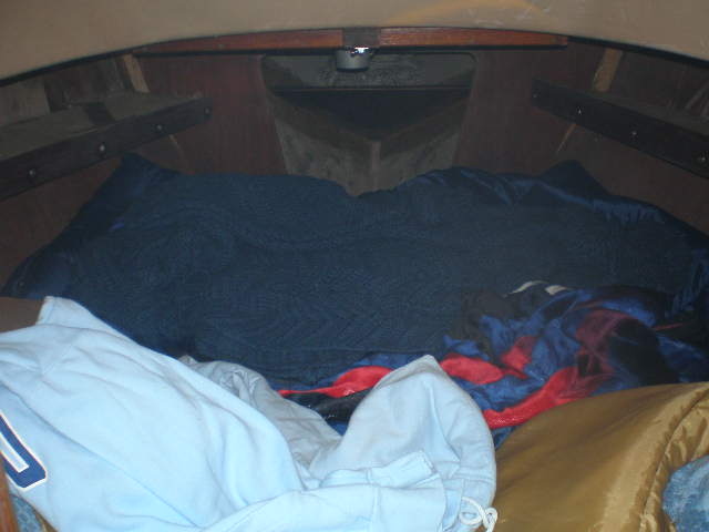

Went to the boat today and removed the wood plug in the V structure that is in the way of getting the tank lid off. I also removed the wooden trime pieces on the shelves. The shelf on the port side seems to have some rot in it plywood..
taken when we initially bought ole sal
just below the forward chainplate knee, so i will replace it. how do i tell if the chainplate knee is rotten too? it looks like it is completed encased in several layers od roven woven cloth...
as you can see boat was very damp inside when we bought her.
the knee feels solid and i cannot compress it at all, but if it is infact rotten, could I split the knee down the center, remove rotten wood, clean it up and install new plywood with epoxy of course and the then just glass over the existing roven material?........ i guess what i am asking can this be repaired without cutting the entire knee out? Thanks more pics to follow.

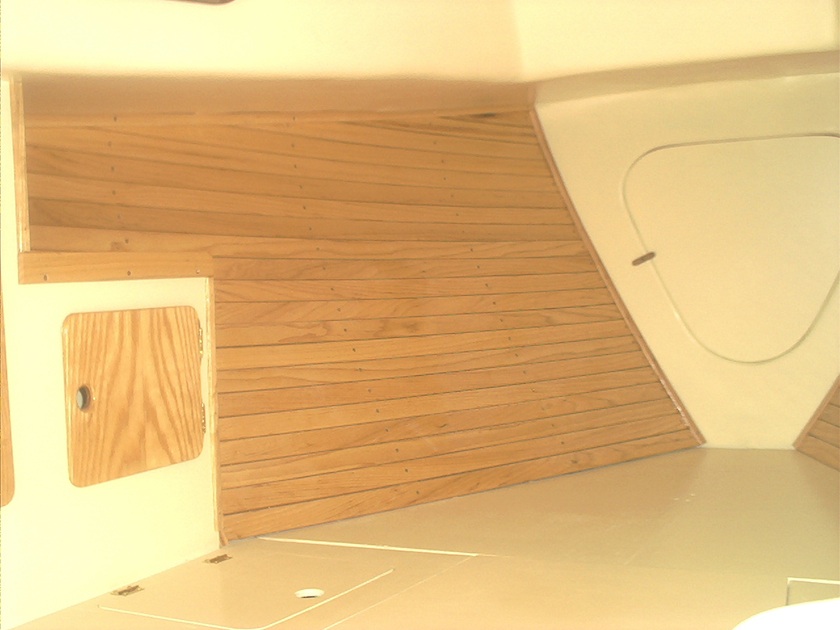

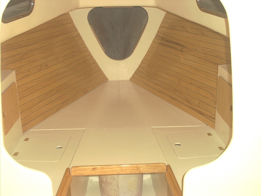

[Edited to improve/add photos]

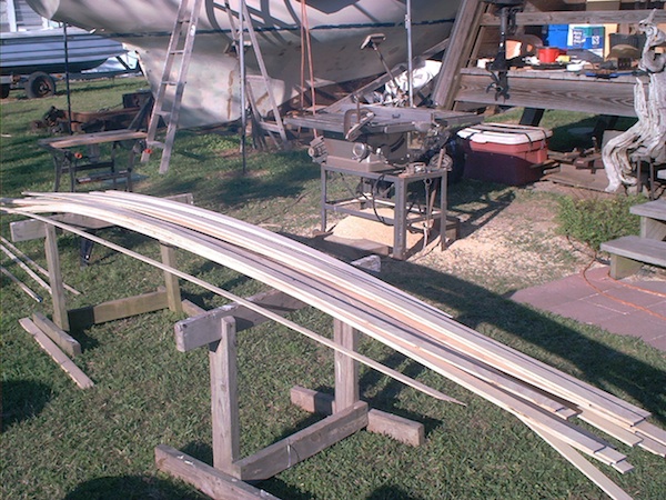

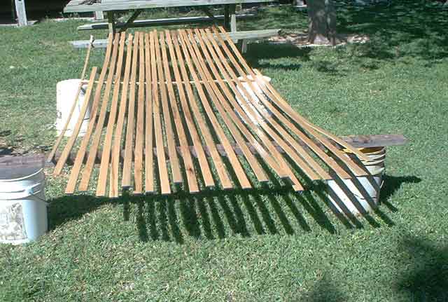

Here are a couple of photos showing the ash ceiling on CharlieJ's "Tehani," which is a 25' CCA-type design. The strips are fairly thin (they re-sawed them), but not overly so. You can't see anything exact in these photos, but they give some idea of the overall scale/thickness:
Cutting ceiling strips
Varnished strip stock

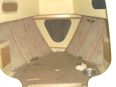

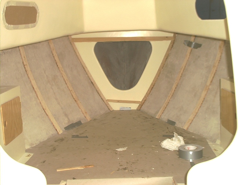

Originally the hullsides in the v-berth were just painted fiberglass. The cleats are 1/2" ply, kerfed on the outboard side and set in thickened epoxy (the paint was ground off in preparation). The insulation is 1/2" polyisocyanurate, friction fit.
A couple of notes:
1) As you can see, these strips were run parallel to the berth flat. Another way is to run them parallel with the deck.
2) You can just see a pair of lockers port and starboard at the after ends of the berth. These were added (and not quite finished here; they later got fiddles, etc.) and created quite a bit of stowage.
1/2" ply cleats installed

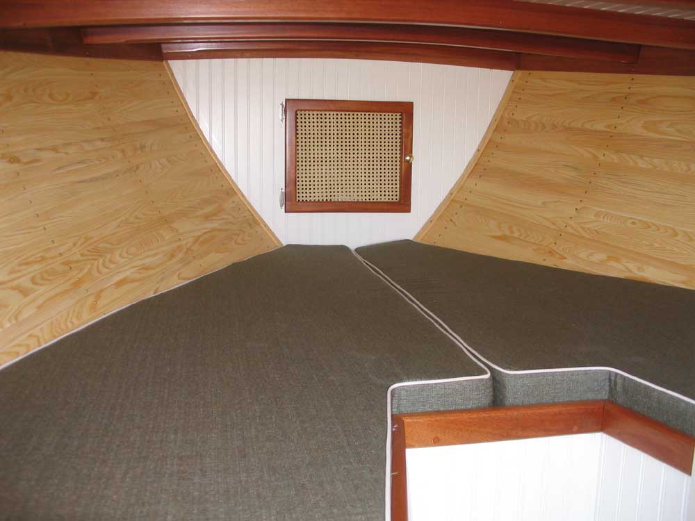

Ash and Cypress are commonly used woods for hull ceilings. I used satinwood primarily because a friend had a large supply and it looks very similar to cypress when varnished.
Here is a pic of satinwood ceilings installed aboard Early Light.
Satinwood hull ceilings in V-berth
I have documented the v-berth hull ceiling project on my website at http://earlylight160.110mb.com/HullCeilings.html
I also added ceilings in the salon book shelves and locker spaces. This project is documented at http://earlylight160.110mb.com/HullCeilingsSalon.html
I hope this is helpful.

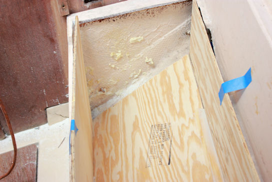

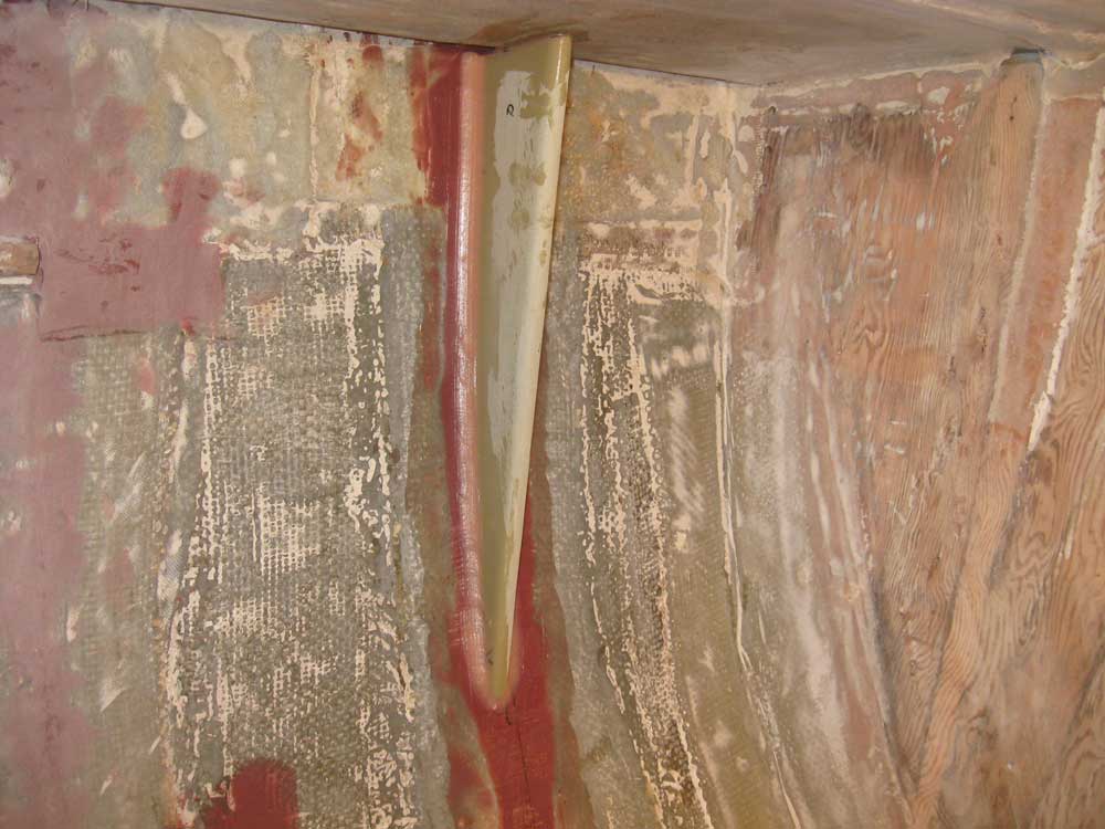

Back on the subject of chainplate knees, I happened to run across the installation log for a set of fiberglass knees on the Triton "Circe," while I was looking for something else, and I thought of this thread:
http://www.lackeysailing.com/circe/august09/82509.htm
(There are "Previous" and "Next" links at the bottom of each page.)
A sample photo:

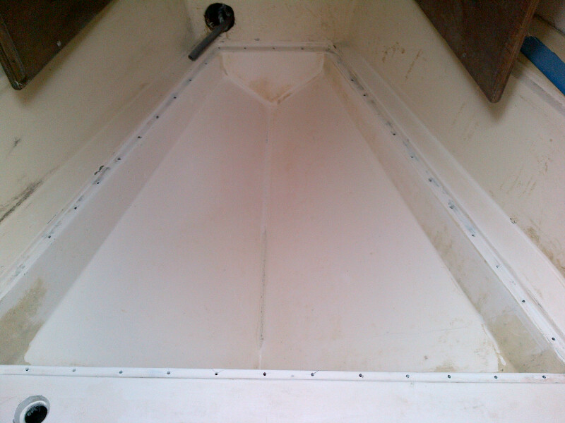

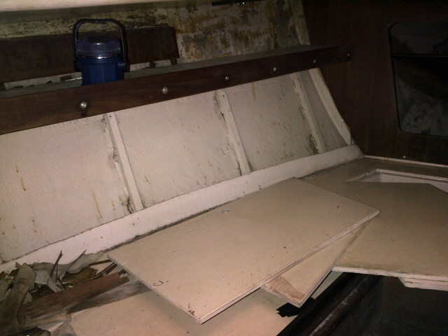

Well, I got the wood work loose and put forward. i then drilled the rivets in tank cover and got the tank lid off. it was not nice in there, black mold, dirt and the underside of the aluminum lid was just horrible, severely corroded
wood work removed
wood work removed
Yuck!
Yuck!
I have the tank lid in the truck, i will take a pic and post it tomorrow. Now i need a new lid and possibly a pick up assembly. where to get a piece os starboad large enough, has to be 42"x36"x 1/4" min.

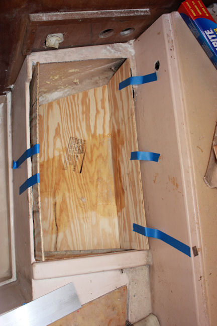

I am going to make a new tank lid, want to use starboard......but the piece i need is $250+.........yikes!!!!!!! so i am still think of what would be an alternative. I am think epoxy coated plywood. Can I use this kit no matter ehat material I use,Water Tank Relocation Kit for Todd Poly Tanks Model # 486613? Can you guys think of alternatives to $250 starboard? Thanks

good question, never worked with it before, but that was used in the link above in another alberg 30 similar to mine.

I'm not sure what I would use in your situation, but I wouldn't use Starboard. Reasons being that it is not particularly rigid, it's heavy for what you get, its surface tends to pick up dirt and not be "cleanable," and it does not take adhesives well. (I'm also not sure how it rates in the "healthy, non-leaching, potable" arena, but since I would already have ruled it out I wouldn't/haven't checked.)
My preference for water tanks is a complete stainless steel tank, but that doesn't fit in with re-using what you have, hence my not having a ready answer for what I would do with your existing tank.

A newer material option that could be used as a barrier coating between the plywood and water is polysiloxane. It's a low toxicity material that is used in food grade applications, and it has superior properties over polyurethanes and epoxies in many respects. Ameron sells it under the name PSX-700. I've used it on my boat.
It was originally developed as the space shuttle launch pad coating. http://www.sti.nasa.gov/tto/spinoff1996/67.html

I have been thinking about this all day. I am going to make a plywood lid and epoxy coat it. This only has to last a couple of years and will not break the bank( i am doing the standing rigging this winter too). It will also give me some much needed experience with west system. I did some internet research and went to Atomvoyaging site, then asked around today and feel comfortable with the epoxy. I will keep you guys posted with pics.

I have made some progress this past week. I got the old tank lid stripped down and removed all the old fitting. I will reuse them in my new lid. i went and bought my first gallon of west system. I got the new lid cut out of 1/4" plywood and got one side epoxy coated. I removed and sanded some of the wood trim from the v-berth. my intention was to replace it but after some sanding it is cleaning up quite nicely. I have some pics and i will upload later this evening.
Cruiser2B
Topside Painter
Posts: 134
Joined: Sun Jul 31, 2011 6:27 pm
Boat Name: Salacia
Boat Type: Alberg 30
Post by Cruiser2B »
Nasty old lid top side with pickup still installed
even nastier bottom, completely corroded.....i dont think a little bleach would have cleaned this up!
new lid...ah yes...the proper tools! :)
bottom side of new lid, with a single coat of epoxy
I plan on about 5 layers of epoxy with 2 layer of fiberglass 6oz cloth on the bottom and the same for the top with the exception of only one layer of fiberglass. I am also going to glass edges all the way around with some 4" fg tape. I am not sure if this is correct, so place let me know if you would cover this plywood lid differently.

I got the tank all cleaned and ready for a few coats of resin rich west system. i looked at many options and decided this would be the best and most cost effective way to go. i also pulled my chainplates. I also bagan sanding the overhead. the paint was pretty puch falling off. i think i am down to the gelcoat, but still lots of sanding left! been pretty good sailing weather here. I have been kind of bummed about not getting out.
still have to touch up corners by hand.

been making slow and steady progress. I have removed alot of the old paint from the overheads. I am taking the mast off on Monday...I will have some pics soon....berthing area too nasty for my cell phones

I know I have been away for a while. Unfortunately I was on a not so enjoyable trip to Afghanistan. I have returned safely and I am now back to getting the vberth and water tank finished. I finished replacing all the standing rigging and got the mast back up just a few day before leaving back in February. While I had the vberth torn down I decided to redo my holding tank as well. I had a very small one in there from the previous owner. I could not find one that was fit the space so i have decide to make one from plywood and epoxy. I cut away some of the liner to increase the size and capacity. I figure from the dimensions I should have about an 11 gallon tank when finished. I am determined to go cruising the chesapeake this year so I have alot of work ahead of me. I will keep you all posted on progress.
initial pieces being fitted
epoxied it in place(not to the hull) so I could get the proper angles. I will build the rest on the bench. More pics to follow

Cape Dory 22's (another Alberg design) have ash ceilings, with satin finish varnish. Very nice and classy.
There's a 15 gallon water tank under the v-berth.
