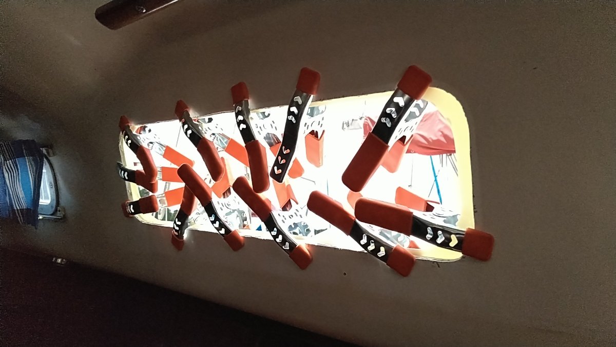

Here you can see the exterior backing plate being epoxied into place. I dry fitted them into place first, with the ports in place, moved everything around until it was symmetrical and correctly placed, then put tape on to mark locations. Then I epoxied first the outer and then the inner sheets in place.

This photo shows one right after installation - before I through-bolted the G-10 to the hull side with 1/4x20 bolts (8 per window.) You can see some sunlight shining through around the port because I haven't filled the area yet with pure silicone caulking which I think will be fine in a completely enclosed protected area above the waterline. If I ever run into problems, I can pull it out and fill with thickened epoxy.
